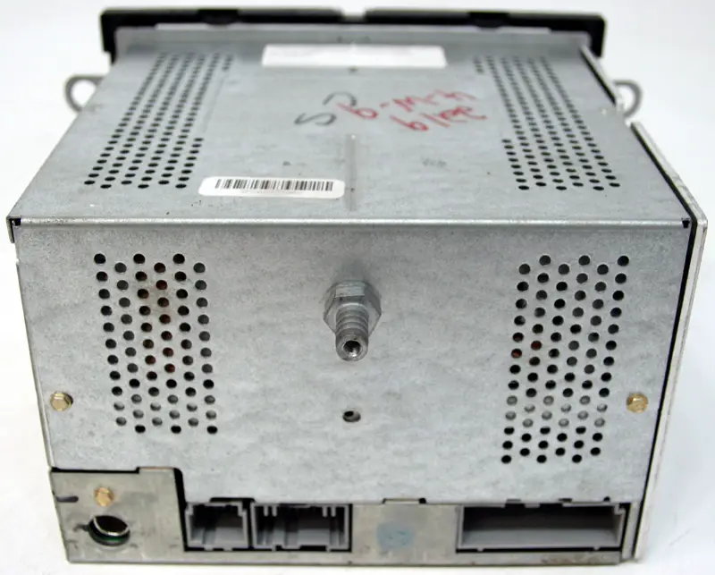

07LTD that radio only has 2 connectors on it I would need 3. I can not find a single disk made that way. I would need one like this with that extra 3rd connector in the back.

Third connector is for the sub. Problem with these stereos is they us the CAN BUS to control all the functions, so even though it may plug in and turn on in another truck with the premium audio system, odds are it will not work properly. These models also have a filter that cut the lows to the regular speakers so you miss sound unless you have the sub.
