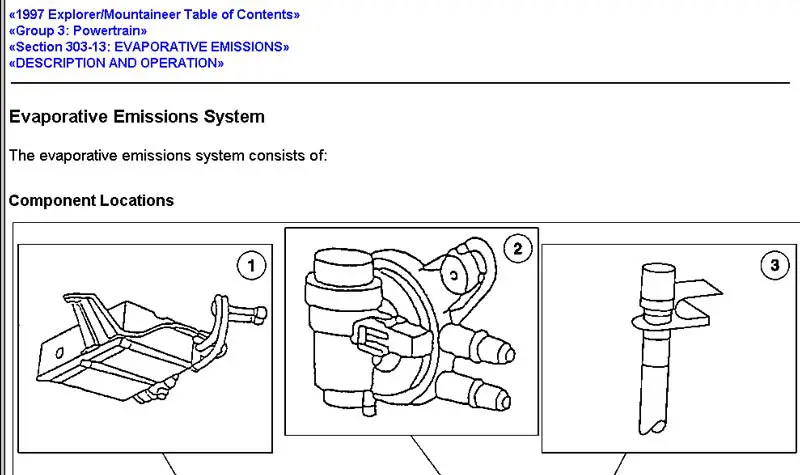

Engine light came on with code P0455 (Evaporative Emission system leak: large). What can I check?

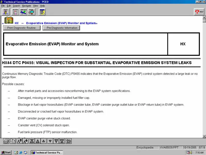

Some info

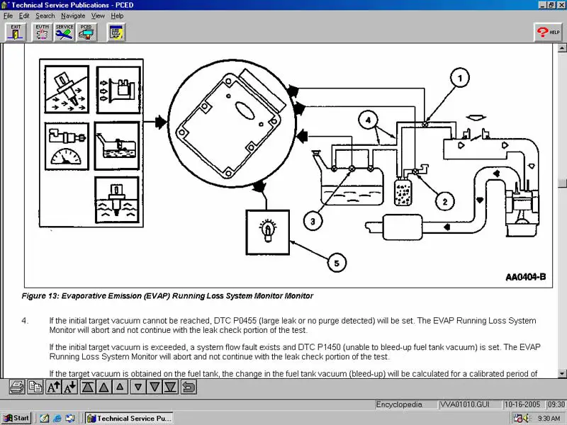

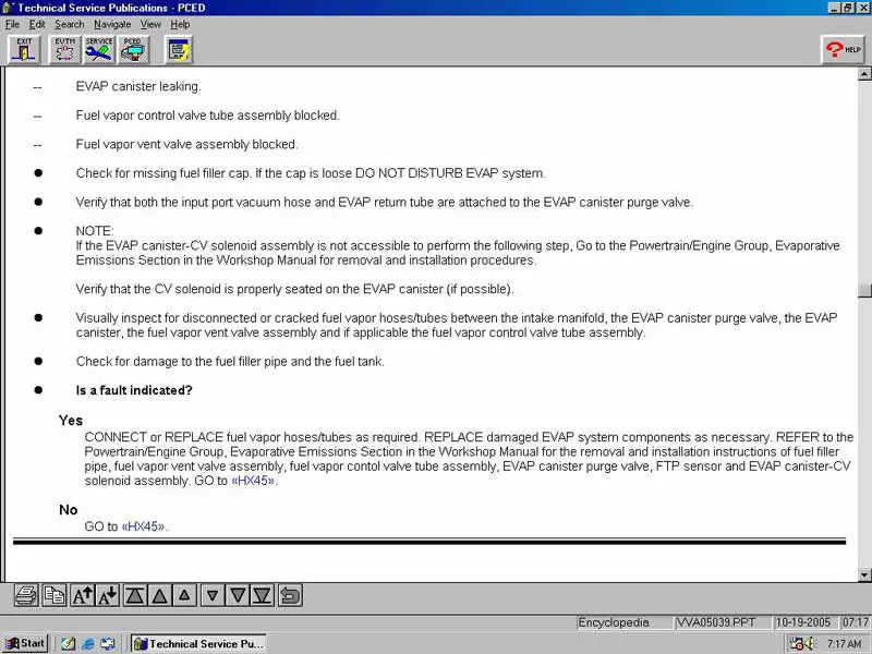

More info

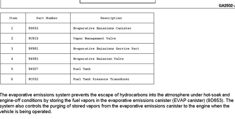

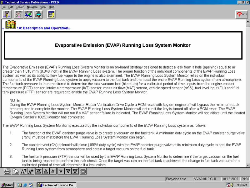

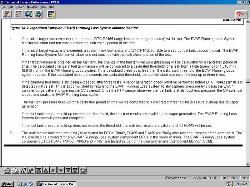

More than you ever wanted to know
Wow, good stuff for diagnosing the EVAP system, Dogfriend. :thumbsup:

Sderaad, the most common cause of this code is a loose fuel cap, or damaged O-ring seal, so check that first.

Thanks for all of the excellent info. I'll try the gas cap first, but now I know where to go if thats nor the fix.

P0455 code. 02 Sport Trac, similar problem, found a hose off over the spare tire, I believe gas tank to canister, snapped back in. Hope it works.

having the same code come up and some harsh starts, had a line off vapor management valve pop off and melt. mileage has been down a lot lately
