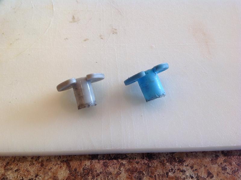

My first mistake, I suppose, was buying the Performance Products brand disconnectors, instead of the better quality looking Lisle ones. The line going to the engine came off with a little difficulty, the real trouble started when I tried getting the one coming from the tank off. I tried and tried, worked and worked, but the stupid thing would not come off. "Quick disconnect" my...anyway, nothing I tried seemed to work. Repositioning the tool, pushing, twisting, pulling, cussing, yelling, nothing. One of the little tabs started to separate from the tool, then I started to worry the tool might break off down in the collar and I wouldn't be able to get it out, so I ran back down to the store and bought a metal tool.

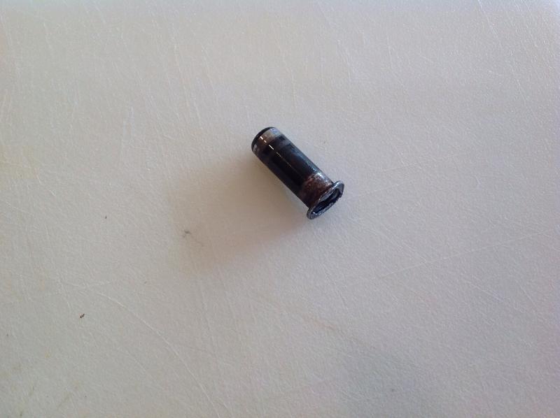

Returning home, working in the rain, I tried to make the metal tool work and, still, no luck. Finally, after much, much work, it started to give. Slowly, slowly it campe out, and then...HOLY CRAP!!!! PART OF THE FILTER TUBE BROKE OFF IN THE FUEL LINE!!!! I'm not proud of it, but much cussing followed. Lying there on the ground, looking at the fuel line, I worked through the five stages of grief. "What now? Am I going to have to drop the tank and replace the whole fuel line, all for the sake of a freaking fuel filter????"
Then, I saw it, the little, mangled cage with the one-way fingers sitting in the end of the line. "If I can get that out, I think I can shape back the way it should be, and it'll give me access to the broken tube piece." Using a little screwdrive and needlenose pliers, I was able to carefully turn the little cage in on itself and remove. I then used an easy out carefully grab the broken filter piece and pull it from the fuel line. I then used the pliers to carefully bend the little cage teeth back into position, reform it into a semi-circle, and pushed it back into the end of the line. Things were finally looking up!

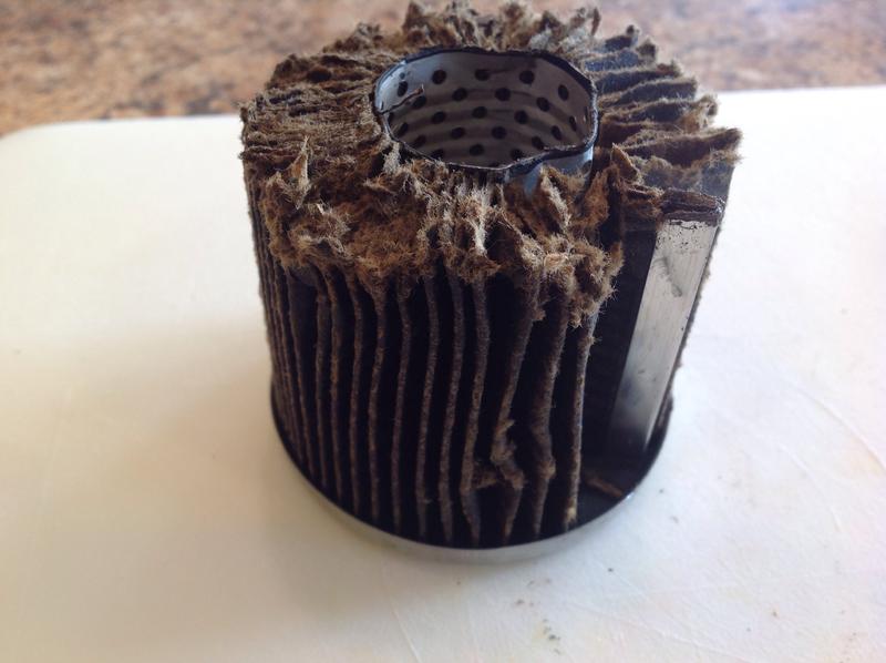

Out of curiosity, I broken open the old filter to see what it looked like inside. Looks pretty bad, but I don't know what one would like like at 30,000 miles.
Pictures of the filter, crappy, chewed up tools, and broken tube piece.

Crappy little tools:

Broken tube:

Glad you got it all back together! I had almost an identical experience changing my filter, too. Only difference with mine was that even with relieving the pressure, and cranking for a couple of minutes to make sure, I still got a gas bath when the damped thing finally came loose! The rear was definitely harder to remove that the front, and I too ended up with a mangled "cage" that had to be re-shaped in order to put the new filter in. Maybe it's just the 94s that do it? :p
I did all of the cussing, but nothing actually broke. It was just a PAIN to get off. Those plastic tools are a joke. It was worth the $8 for the good one.
I certainly felt moments of utter desperation. Researching later, I found this is not an uncommon problem, and that the replacement cages are easily available. Next time I'll grab some of those before I start, just in case I bugger one up bad enough I can't bend it back into shape.

I've always had hard time getting at least one Fuel line apart using the quick disconnect tools. The problem I was having was that I couldn't press the tool into the fitting with enough force to release the garter spring inside. What helped a lot was using needle nose pliers to force the tool into the fitting. The pliers were able to exert much more force than just using my hands alone.
Here's the secret:
When you press the line into the filter it releases the grabbers. The tool is then inserted. (no real force necessary) the tool then "holds" the grabbers open allowing the tube to slip out.
The tool is not intended to be used to "force" it to disconnect.. ..this is why they are plastic.
Finesse fellas, not brute force on this one.
Finesse won't save them all. Half the time I have to scrape the mud an rust out first, then soak it in my acetone/ATF mix. After all that it's a crap shoot whether they connect again. I just had that problem with my fuel line to my fuel rail. A trick I found is to twist as you push in. For some reason this works great. The hf aluminum tools is all I use. The plastic ones are a one use tool, and you can't twist them.

I don't know if you're dealing with garter springs, or the internal, squirrel cage type fingered springs. If it's the internal type, you might just go grab some new ones from an auto parts store, then simply cut through the tube of the filter. Once you do this, and get the filter body out of the way, you can pull the spring out with a little screwdriver, a pick, or maybe needlenose pliers. Then pull out the tail of the tube out of the line, insert a new spring, and then you'll be able to get everything buttoned up in less than 10 minutes. This is how I'll do it next time.
