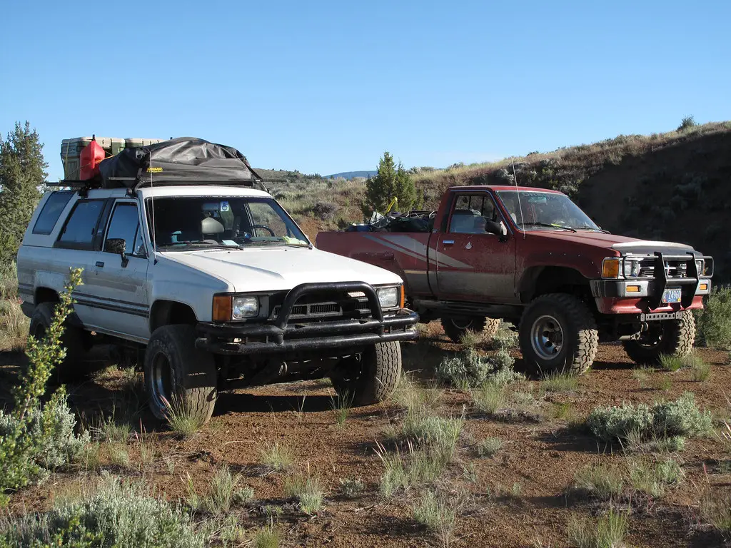

Hey hey hey, don't knock the Runners, man! ;)
If I could combine the offroad prowess of my '86 4Runner with the comfort and load capacity of my '00 Explorer, I'd be a happy happy happy dude.
My 4Runner on the left.
Splodey's feeling the weight a little here, but the Toyota wouldn't have made it out the driveway with that load!
