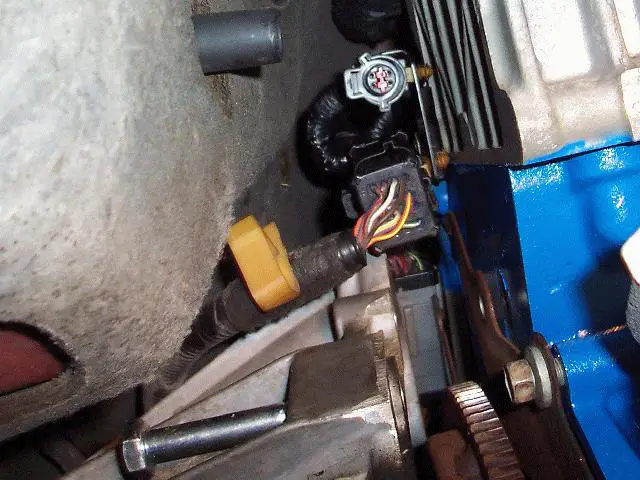

ok ill do it tomorrow. getting closer to giving up. is there a diagram of that 16 pin plug?
c177

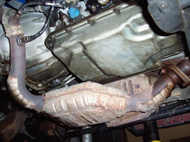

Bank 1 Sensor 2
P0141 02 Sensor Heater Circuit Malfunction (Bank 1 Sensor 2)
I would try to solve the above failure first. That may lead you to the source of the other failures. Bank 1 Sensor 2 should be the passenger side post cat sensor if you have 4 total O2 sensors. There are some 3 sensor configurations. If you disconnect the plug ( C181, 4 pins) to the O2 sensor there should be battery voltage (from fuse 13) on the LightBlue/Orange wire when the ignition is on.

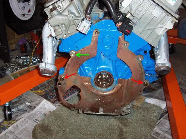

ok I'm basically stripping the car at this point. i removed the intake manifold to see where everything ran. maybe this can help. i check the blue and orange wire from the harness in the engine bay. i got 12 volts. BUT I checked the four pin connecter to the o2 sensor and i only got about 3 volts. any clues?

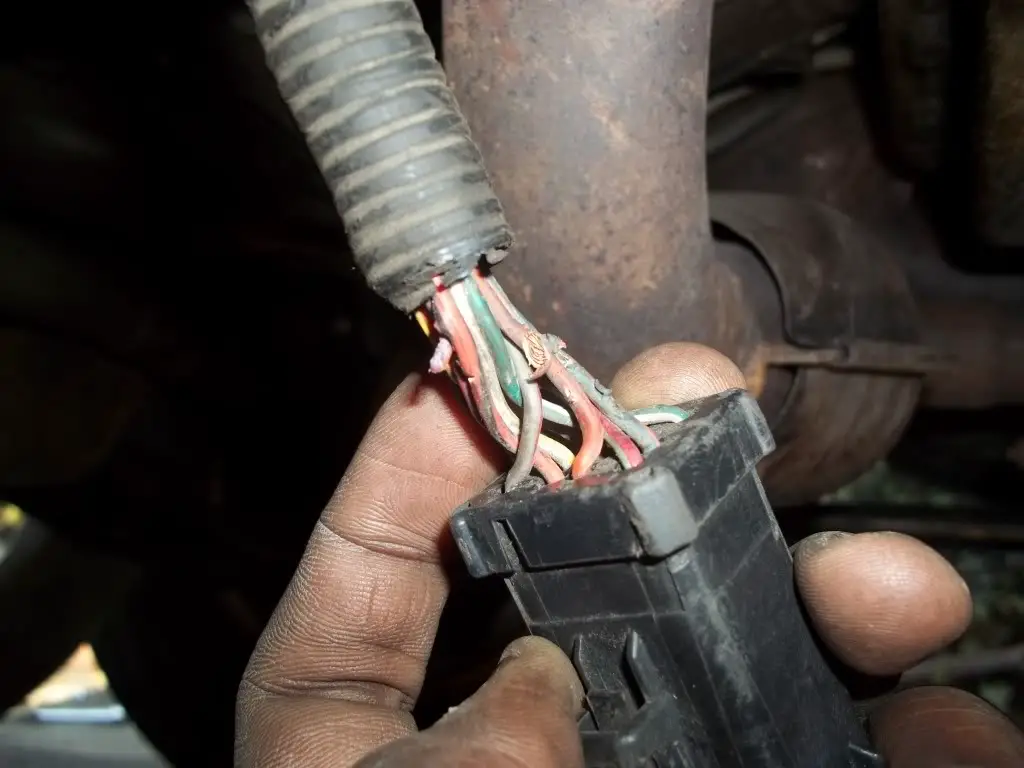

ok today i took apart the intake manifold to get to those wires. i learned that the female pin for the blue/orange wire was pushed in and no power was going to the o2 and transmission. i fixed that but the problem still exists. the continuity fine. the resistance was .01 or .00. i haven't checked the voltage for that o2 sensor but any suggestions?

If the LB/OG pin was pushed back then there would be no power to the O2 sensor heaters and the transmission solenoids (torque converter clutch, electronic pressure control, shift A, B , C & D). That would have triggered the codes that were displayed just as if fuse 13 were blown. Have you cleared the old codes by using a code reader or disconnecting the battery?

the pin was not staying put so i spliced a wire right across the connectors. ITS BACK TO LIFE. THANKS FOR YOUR HELP. b4 i put it back on the road i need a battery, brakes, and the heater control valve is dripping coolant from the top so ill replace that. Question: Now when i steer it vibrates the whole truck when its near the center point. the power steering fluid is fine. would it be because its been sitting and needs to be broken in?
