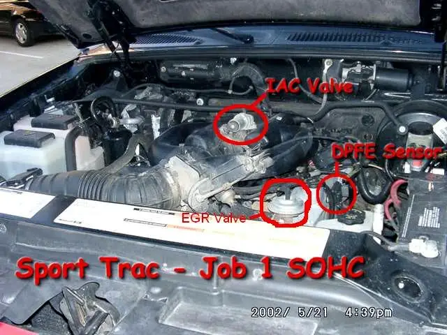

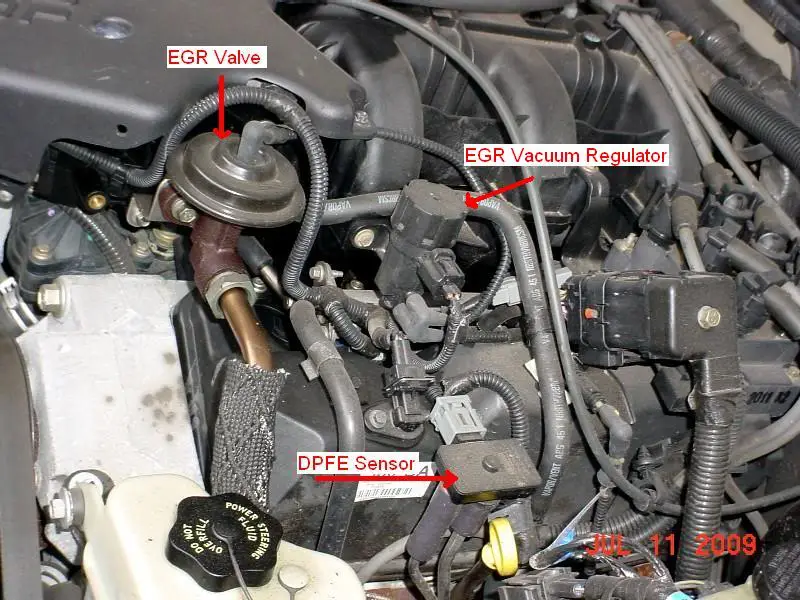

Is yours a Job 1 or 2 2001?

Which solenoid thing are you talking about?
Job 2
Job 1
