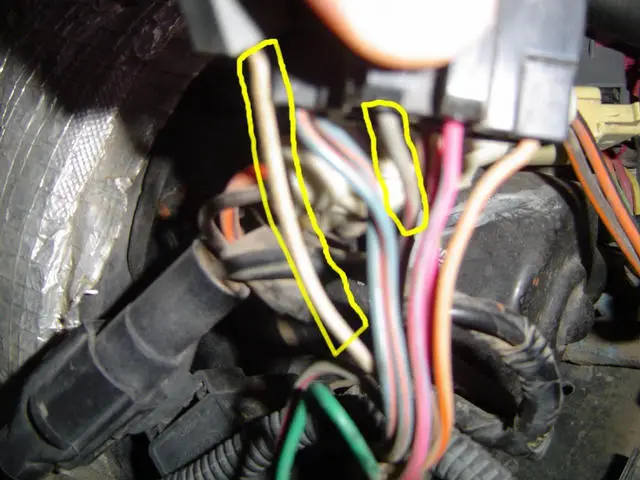

1) Ok, now for the fun stuff. As always, disconnect the negitive terminal on the battery for safety. Then, locate the diagnostic test terminal, near the blower fan, on the passenger side in the engine compartment:
Normally, the two pins that are circled are the ones you would connect the jumper wire too. What this mod will do, is install a permenant jumper wire, with a break(toggle switch) in it so the user(you) will be able to put the PCM in diagnostic mode, whenever the user(you) needs to pull a code(s).
FYI, the single grey pin in the upper left of the picture is your Self Test Input pin. And the other pin on the black 6 Pin terminal, is the Signal Return Pin(Pin 2). For simple code pulling, and for this mod, these are the only two you need to worry about.
Next, write(or remember, doesn't matter) the wire that is going to each pin. Wires might be different for each vehicle, so I won't specify a certain color wire for each pin. These two wires will be found in the passenger kick panel, where the PCM is located. Just remember what the wires are.

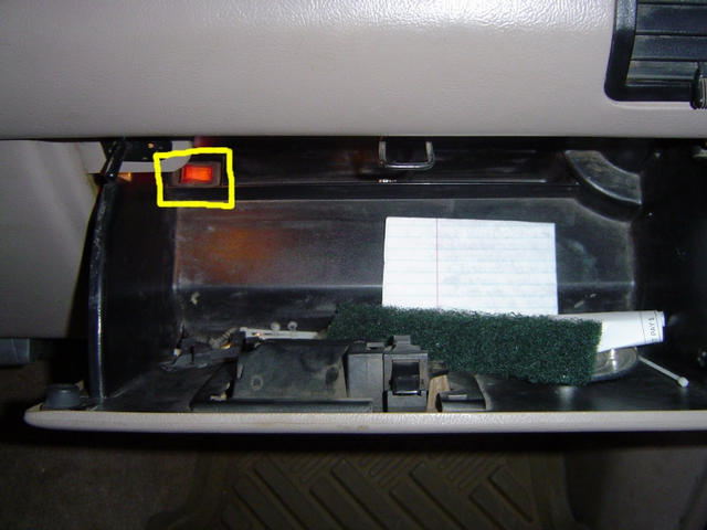

2)Find a location for your toggle switch. Anywhere you would like it, but remember. You don't want to be going down the road, and accidently push the button, and have the computer go into diagnostics mode. That will be bad for you! I chose my glove box. It's hidden, not able to be triggered, and out of my way until I need it.
Note: Mounting the switch to this location did require me to remove the glove box door. See your repair manual for instructions.
That little hole was perfect for that toggle switch. I did have to remove the glove box, and drill out the plastic behind it for the wires, but no big deal.
Next, install your wires to the contacts on the back of the switch, via connectors or soldering. Then install the switch wherever you like, and run the wires to the passenger kick panel.

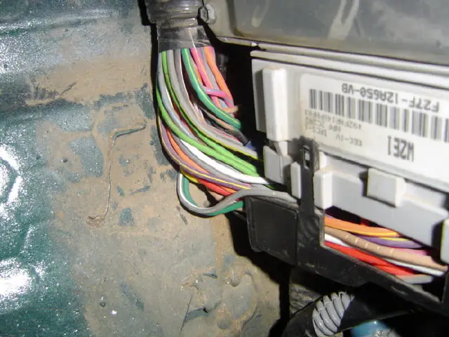

3) Remove the plastic kick panel to expose the PCM.
I found it worked best to remove the PCM from the bracket, and then remove the wiring harness from the PCM, to locate and splice into the PCM wires. This is where you need to find the two wires that you wrote down earlier from the diagnostics test terminal. Once the two wires are found, splice your two new wires into the diagnostics test teminal wires. Therefore, creating the permenant jumper wire. Make sure the splice is solid, and firm, then reinstall your wiring harness, PCM, and kick panel. To make sure everything is working properly, get a continuinty meter(Multimeter)and turn the switch on(Battery is still disconnected). The go inside the engine compartment, and stick the multimeter pins into the above cirlced pins(1st picture). There should be continuinty between those two pins. Now turn the switch off, and repeat. There should now be no continuinty between the two pins. If you yeild these results, your done!
