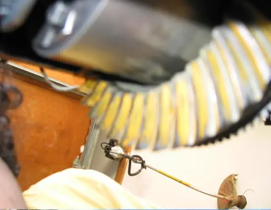

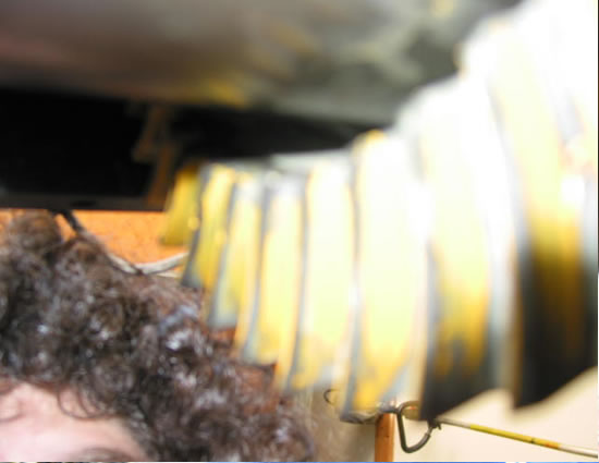

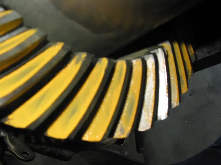

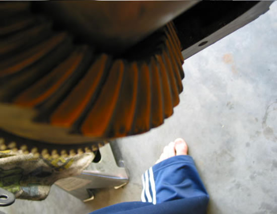

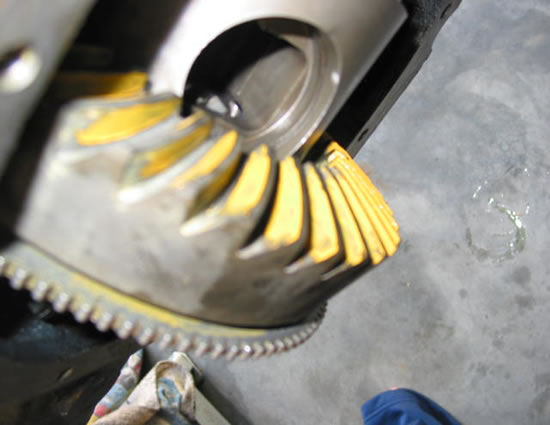

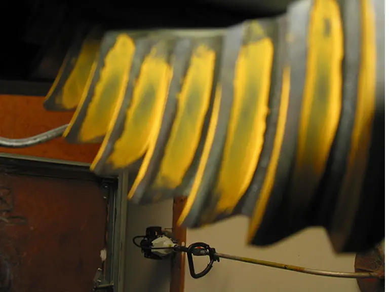

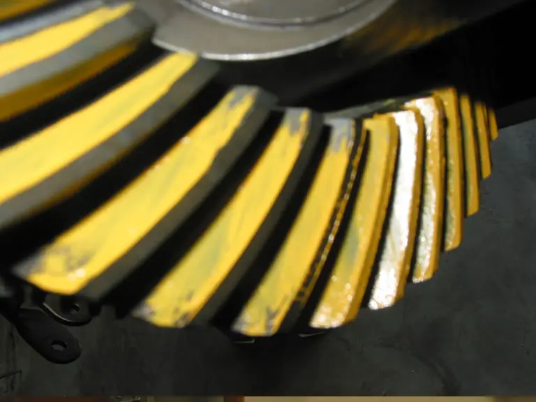

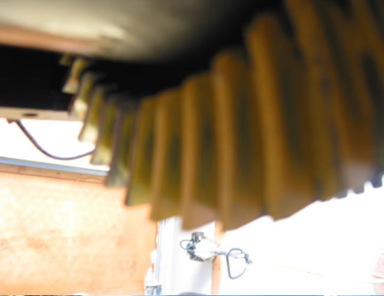

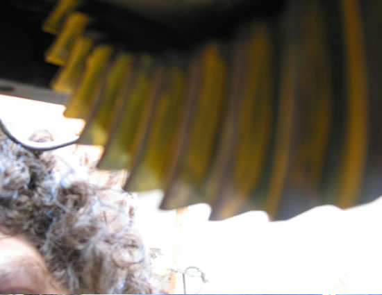

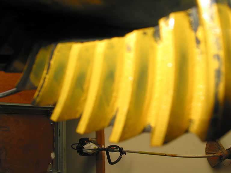

Whats up guys. I have been installing my own gears (for the first time) and i think i got it right. I am not completely sure if i got it right, so i wanted to see if anyone (who knows whats up) could check out my pattern and tell me if im good to go or not.
Some of them are kind of dark, and at intresting angles, but you should beable to get the jist of the pattern.

anyone able to make anything out from those pictures?

yeah...comb your hair..lol...looks great to me. Some shots were a little blurry but seems fine

pattern looks good, I'd run them from what I can make out.
ken.
Yeah the patterns do look pretty good. Good on heel and toe. Good stuff.

im going to try and get cleaner pictures tomorrow.
Hey check these out... MUCH clearer!

last one

oh yes you got it
yesss.
