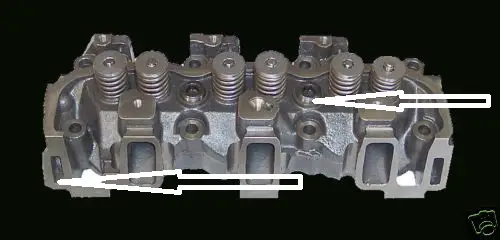

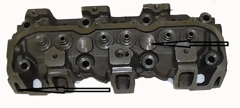

Those images are great comparison info for "new" verses "remans"
check it out:
Notice the water ports and bore holes: square water port = "new"
: threaded bore plugs = "new"
NOT NEW:
Hope their not actually selling the one in the picture: see the dented valve guide?
Good find,
I think I'll have to buy a set just in case.
Their not gonna get cheaper down the road.
I think "dono" runs kings and pretty sure they were new style. I think my stock ones has threaded plugs tho...ill check that and what tm they are
O wait the second pic is from eq...I know those are new cast.I have bought a couple sets from them.the pic is not what they look like in person
I would hope a even a reman would have the plugs knocked out and tap'd for threaded plugs.
Are the water port differences 90TM vs. 93TM
Not externally
Anyhow the pic is probably just some junk they had for the photo op.
But it's good info for the shopper-be-ware method.
I don't think I would want that water port mismatch on my engine.
