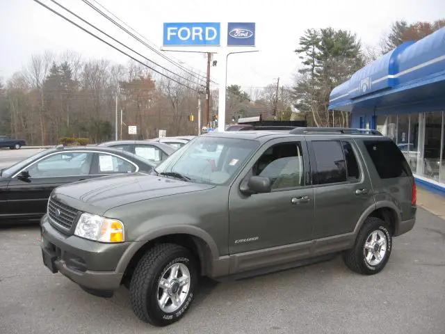

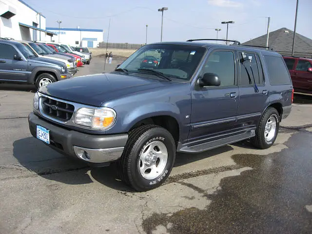

Well, I don't understand the confusion over '02 vs '01, I mean they completely changed the truck in '02, the whole body is different, if its an '02 it should be obvious just looking at it.
Is it possible that a belt for an '02 is really a touch longer than the '01, and that you in fact have an '01, but are buying belts for an '02, and that the whole problem is the belt length?
Well the two belts I bought from NAPA are to long and they were fro the 2001. When I called ford they had me give them my VIN # and said that even thought the body tag says 2001 the vehicle is acyually a 2002. The Ford belt fit better and moved the indicator closer to "new" then any others but now (two weeks and 1,000 miles later) the belt indicator say it's time to replace, the tensioner is jumping back and forth about 1/4 inch and it is chirping/squeeling like a loos belt again. The interesting thing is that whith a new belt the noise goes away so why would it be something else. If a pulley was bad wouldn't it still make the sound regardless of a new/old belt?
Here are pictures of an '01 Ex and an '02 Ex. Which one do you have?
Well according to the demenstration photos you provided I have an "02" most definately.
