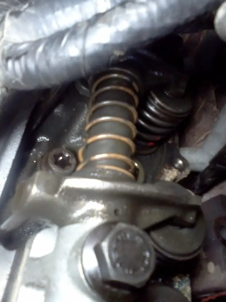

I still can't find what's wrong with my ex I'm getting a cylinder four misfire, I have spark have fuel, I'm thinking its a cracked head but have good compression no chocolate milk on the dipstick no excessive smoke, slight sweet smell but I'm currently pressure testing the radiator for leaks into the cylinder I pulled the valve cover and this is what I found
This is the front spring next to number four cylinder
This is the spring next to the firewall, what do you guys think do you think I might have a cracked head?
