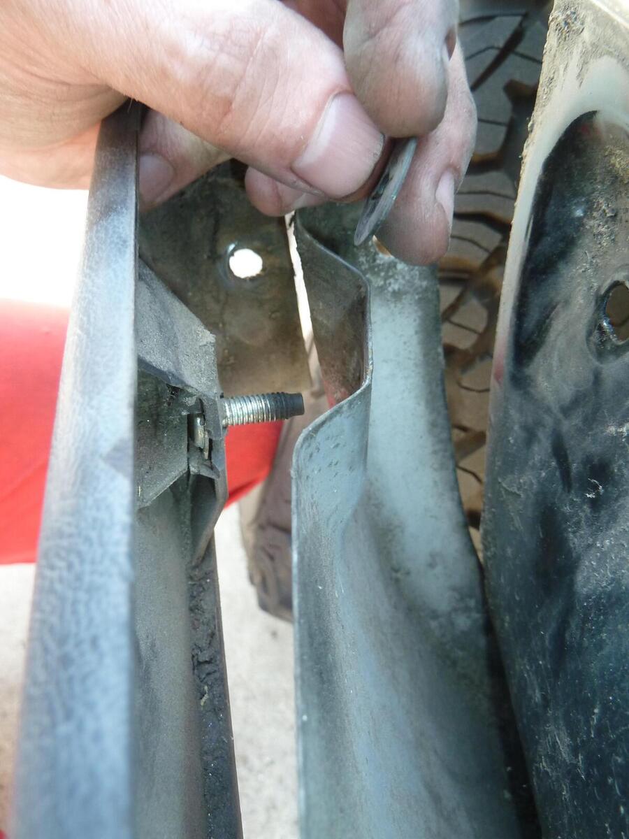

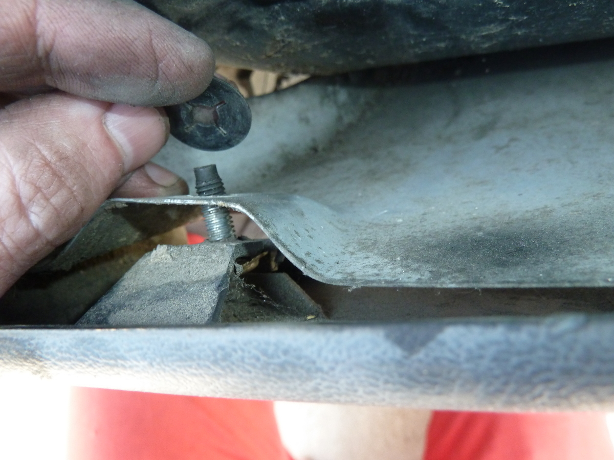

The washer in fingers is plastic retainer for the bolt.
There are 2 bolts.
The bolt can be slid out when the plastic trim is removed from the chrome panel.
So yeah, don't heat. If you don't have access to junkyard, cutoff wheel to the nuts.

Excellent, thank you. Now I have a better idea of how to go at it.
Ok, so using the information that Childldenticant posted I took my time (2 hours for 2 nuts) and got the chrome and plastic trim off the rear quarter. Firstly, the nut and bolt are m6x1 thread if that helps anyone. I oiled and cleaned the threads several times and used a spare nut to run on and off the end of the bolt. Then I took a pair of Vise grips and locked them on the tip of the bolt and started working the nut. Move the nut off as far as it would go easily then retighten. Pull off plyers and wire brush the threads and check with spare nut. More oil, plyers and go as far as it will and retighten. Continue until it comes off all the way. As I said originally, I'm doing this because the truck will be going for a full paint job and want to see if there is rust back there. As it turns out for it's age it is in nice shape. It is just starting around the bolt hole closest to the wheel. It will be an easy fix now. As for the passenger side trim, that will wait for a cooler day as that one will be a bit longer as the tail pipe is there. Again thanks for the help.

Again thanks for the pics, they helped so much. Looking at your location I understand why the fastener is in such great shape. I ended up locking vise grips on the end of the bolt and forcing 2 off. The other 2 I used a small cut off wheel. I live in the salt belt in Canada. This could have all been avoided had Ford used SS nuts and bolts here. If you look at the square retaining head it is really thin. It is like a knife waiting to spin through that plastic. I built my own retainers out of SS. I found a kit of m10 square SS nuts that were the perfect thickness and width to fit the reciever in the plastic moulding. I then took some m6 by 1 inch SS bolts and beveled the head down to a shape that fit them flush in the square nut and had a shop weld them together with SS wire. A little final buffing and they slide right in. Re-assemble, snug to taste and double nut for good measure. Now I can take them off with two wrenches with my eyes closed. Sorry I didn't take any pics.
