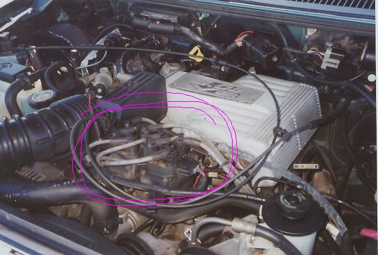

Could anyone circle the parts I need to cover while washing my engine? I want to de-grease the hell out of it and powerwash it. What is the best de-greaser to use?
this one and id cover any electrical part that you can just to be safe as possible.

Coil block (what Redrig circled), alternator, air intake and PCM, everything else is pretty much fair game I think...just be careful around anything that is a fluid fill port.
