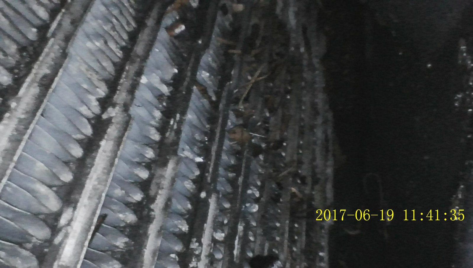

Not only was there a couple inches of "mud" in the corner (which I did not get a picture of, unfortunately - I was too eager to clean it out), but the front side of it was packed full of leaves (right side of the picture is vehicle forward):
Disgusting! Where I could contort my hand, I used a small metal pick to clean the mud out from the fins. There's no way to get the corner though. I did get the leaves out using a plastic scraper:
The final result - not perfect but better than before:
