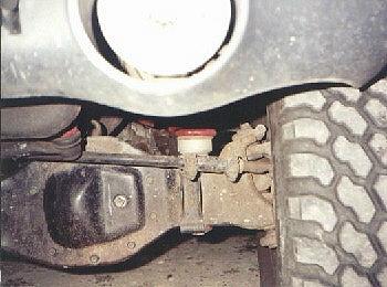

DON'T use spacers that go in between the coils! Those things are dangerous (they can pop out, becoming a missile) and may damage the coil as well (same goes for the kind that clamp onto the side of the coil).
The spacers you want to use go UNDERNEATH the coil spring, and will not stiffen up the ride or cause damage to the spring.
They can be had in the form of 2WD F-150 mounts, or you can make some by stacking some large washers over the axle mount as well.
Yep, those are the F-150 pieces I referred to. They're right about 1.25" thick, which gives a bit under 2" lift on a Twin-Beam suspension.
Put in the order today, gonna run me $50. I guess that is a good price?! I will hopefully have them on by the end of the week, with new Rancho shocks as well. Thanks for the info! :thumbsup:
