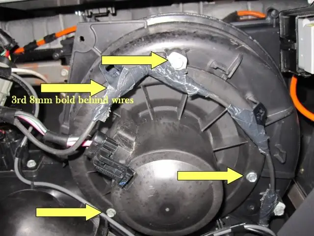

Oh and idk bout any others...but i had too undo 5 8mm bolts....2 front, 1 pass side and 2 drivers side.....one shown in pic and the one thats bolted to the support from underneath right behind it.
The pieces wouldnt pry on that side enough til i did that.

If you look where the blower motor is in the 3rd gens, its really easy to get to. Its under the passenger side dash. Three 8mm bolts + 1 holding the wiring will let it drop out.

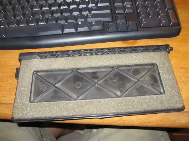

This is the door
Its much bigger than I thought.
