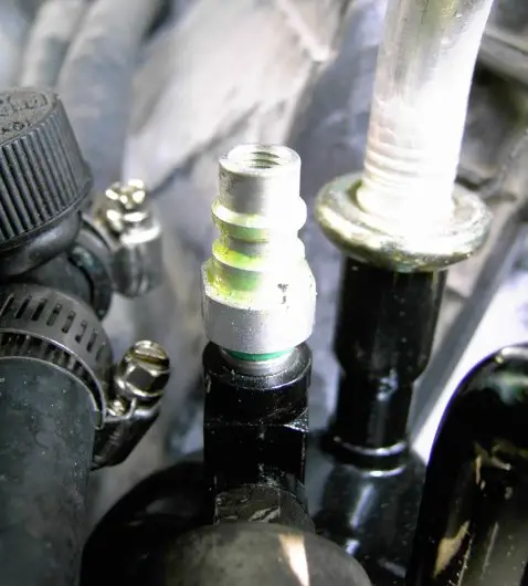

The R134a type hoses are a quick disconnect (QD) type of different sizes. The pic below shows the LOW PRESSURE QD on the accumulator. I don't have a pic handy of the HP side (Driver going to condensor), but it looks similar only a different size.
Without seeing a pic of the fitting you have I am guessing that a previous owner may have installed a post R134a set of hoses (with QD). Another possibility, if it is indeed a QD fitting on you HP fitting, is that a previous owner converted to R134a and then removed the adapter fitting on the LP port because they are notorious for leaking.
All of this, of course, is conjecture on my part. Posting a pic of the HP port and your R12 hose would help in the diagnosis.

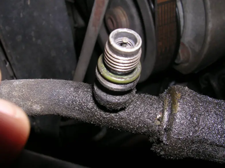

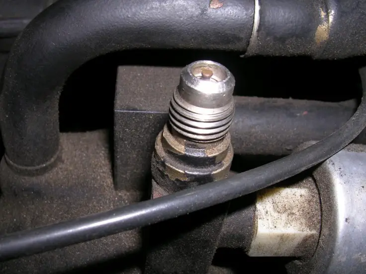

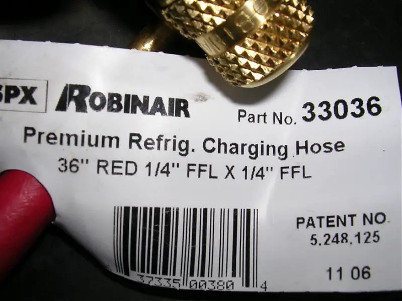

The first pic is the Low Pressure Port, the second is the high pressure port, the third, and most important, is the hose.
The Robinair 30336 red hose is a good generic a/c hose that requires an adapter on one end to use in a R12 automotive air conditioning application.
Technically, you are looking for a 1/4" MFL X 3/16" FFL adapter. Ask at any A/C place, they are a common item. I doubt if the automotive stores carry them, but then I never looked, Wal Marts may. I've attached a picture and a URL with a pic.
