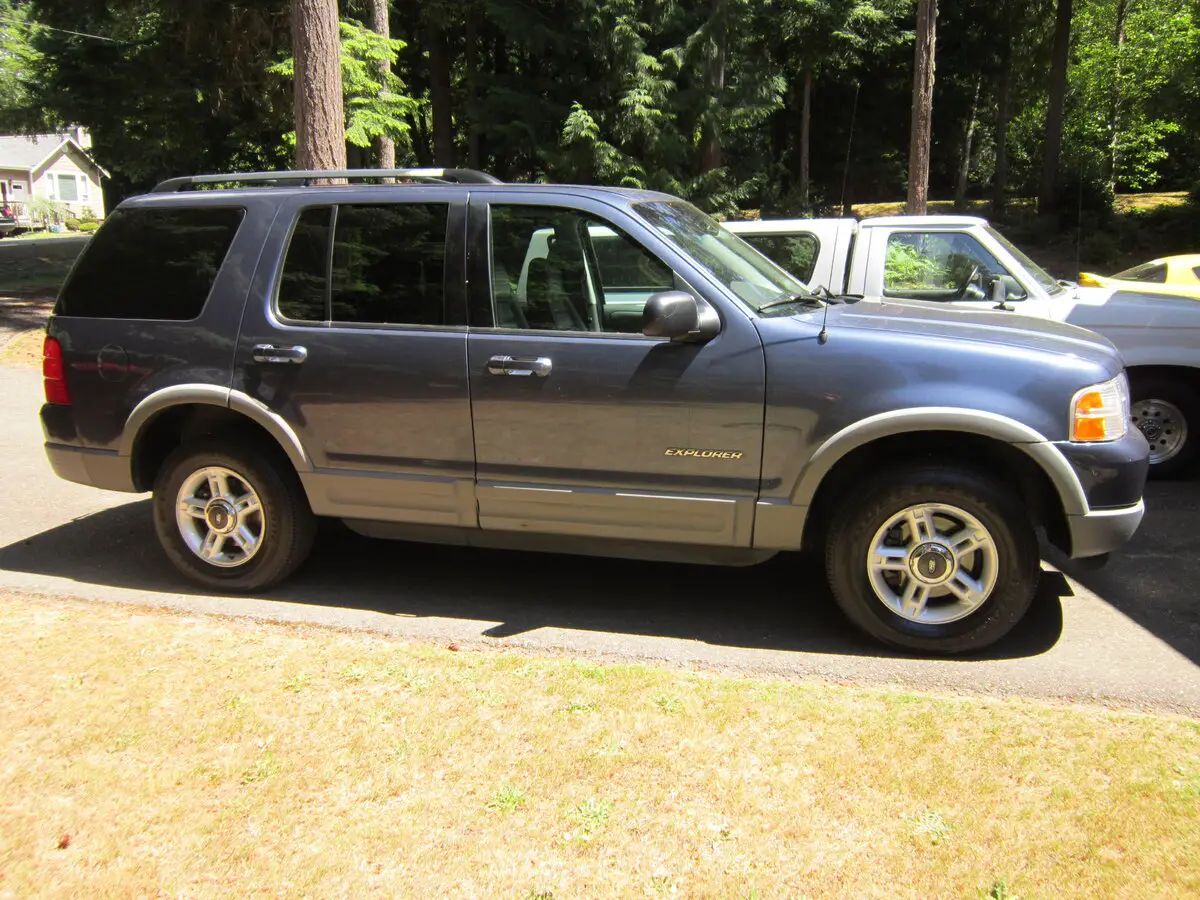

My father offered me his 02 Explorer. he is a mechanic and kept it in good condition.
recently he did the Timing Chains on the engine. Lows KMs. Under 150k. but they're looking for something smaller.
I would get it for very cheap.
My thing is, i had always considered 02 Explorers 100% failure rates.
Yet, up until this point I've never had a transmission failure on any of my explorers.
I guess what im asking is, would you consider this? Has anyone ever had an 02 and never experienced transmission issues?

Thats definitely the kind of info I've been looking for.
Thank you, looks very clean by the way.
