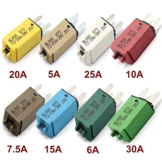

Relevant advice for future troubleshooting: While an option for 2A doesn't seem to be easy to obtain, there exists a "resettable fuse". Can be automatic or manual reset style.
Edit: Welcome to explorerforum.
I need these. I thought the whole time, I bet these exist. Thank you sir!

Currently running a auto trip fuse(special thanks to comment above) and can start the car right back up. (I'm monitoring heat in this fuse box.) Hoping whatever it is just fails so I can find it!
