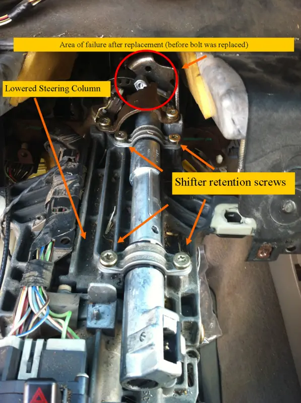

This is the state of dis-assembly that I needed to get to to gain access...
I went far past this point before I discovered that fact.

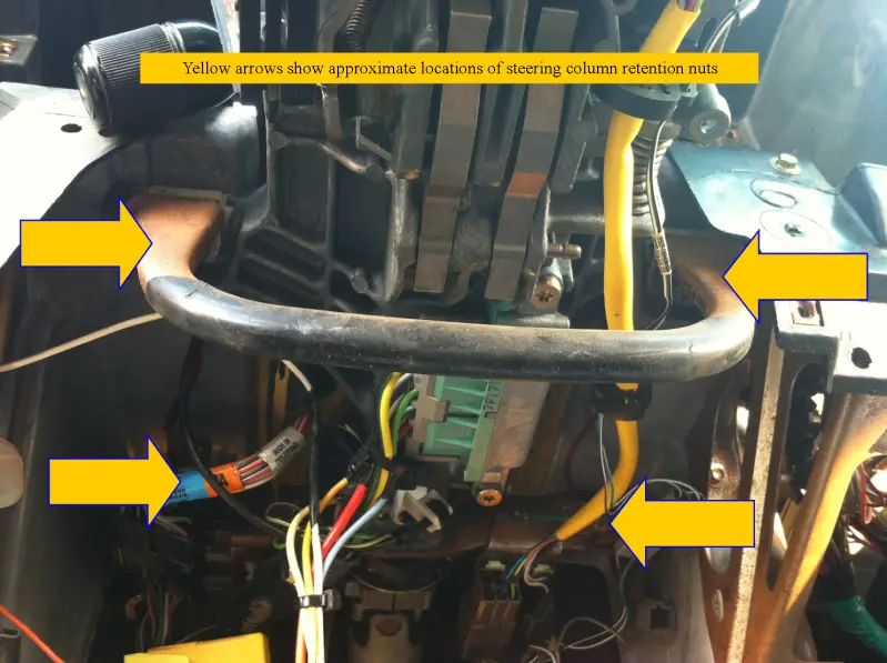

To drop the steering column for access to the shifter rod you will need to locate 4 nuts. The 2 front nuts are easy enough, but the existence of the 2 rear eluded me for quite some time. Failure to find these nuts frustrated the hell out of me. Knowing about their existence would have made this a half day job...

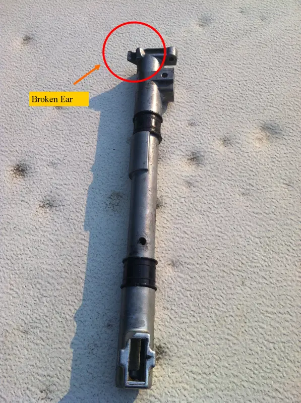

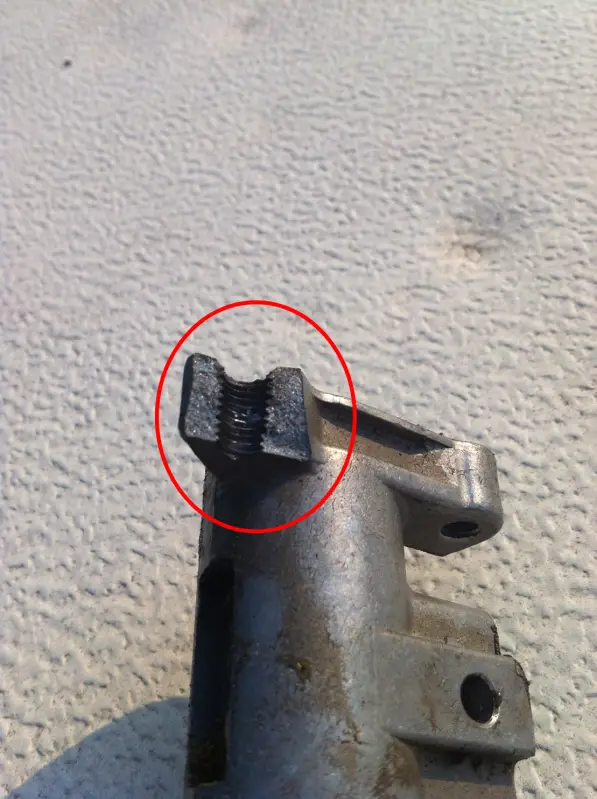

This is 2 detail pictures of the damaged rod...
The ear that connects the shift rod to the linkage sheered perpendicular to the threads.

Remember, if the linkage bolt is loosening or falling out of the shifter rod, the ear the bolt threads into is cracked and failing.
