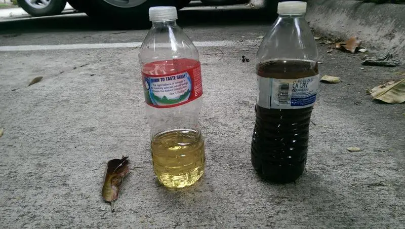

This is an example of my Explorers' brake fluid after a couple of years of use...I know there was nothing added to this brake fluid other than clean fluid from an unopened container back in 2012 when I did new rotors, pads, and parking brake shoes...The right side bottle is what was drained out last month...Now I drive a lot of miles in a year [avg 70 k] so maybe there is more exposure to dirt and contamination but I have done the brake fluid flush in my cars and trucks every 2-3 years and it always looks like this...
I did a clutch on my wifes' car that is 11 years old and it had been 2 years since I changed her cars' brake/clutch fluid and the old fluid looks just like this as well and the clear fluid was the start of what I flushed through the system as a clean catch...And the clutch and brake fluid share the same reservoir so it gets used quite a bit even more than just the brakes...
Obviously you can do what you want but when brake fluid starts to turn darker it is picking up contamination and it will affect the seals and cylinders in that system...And introducing a water and eythyl gylcol mixture, even a small amount, would have me draining the system, flushing it with fresh brake fluid, and hoping like hell that replacing/rebuilding master or slave cylinders and calipers wasn't necessary but looking out for dragging brakes and or non releasing clutch cylinders as a direct result of the antifreeze introduced to the system...
