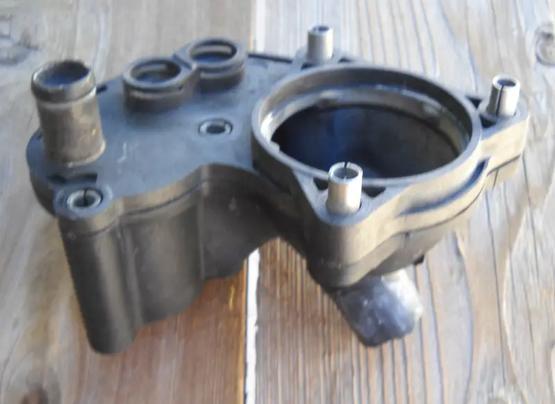

OK, I admit it. Replaced water pump after now and then puddle of coolant under engine. Only occasionally, added water once in a month's time, down ~ a quart. Could not detect any wetness above pump, looking at possibility of cracked thermostat housing (plastic, I've heard they crack). Pump replace went OK, typical. Drove 100 miles, no puddle. This morning, my wife stops the action, she sees the new puddle as I'm ready to pull out of the shop. Look under hood; same as before, see no hint of leakage, the pump pulley obscures completely any view of the pump bleed hole. But, I swear it's GOTTA be the new pump leaking.
Much, much closer look, engine running & hot, pressure up, see no leakage. But, climbed up on step-ladder, hanging over engine room, I see coolant in the valley, congregated around what looks like a freeze plug in the lower manifold, which is new territory for me. I like FEs the best. Then, I see it: wet along seam on thermostat housing, not outlet neck, but below it. Here's the part in question:
So, given the unknowns, made in China, plastic similar, old part said "Ford", new says nothing, if the material is good enough, Cyclolac plastic, maybe,
Seals onto intake manifold using a square-cross section O-ring, like a wide rubber band. P-P idea. The new housing has it's top gasket already sealed in place, thermostat top outlet neck seals with a big O-ring, and the Engine Coolant Temp. Sensor presses into the top using an O-ring to seal it, no threads. Metal clip keeps it from popping out.
Has anyone else ripped one of these abortions apart, studied that factory-installed glue gasket? Vehicle made it to 160K, can't complain really, but metal pleases me more than plastc. They saved maybe half a pound with this thing. I could find no view of the damned thing separated into it's three parts. If you ask, I'll take pics of mine tomorrow. imp
