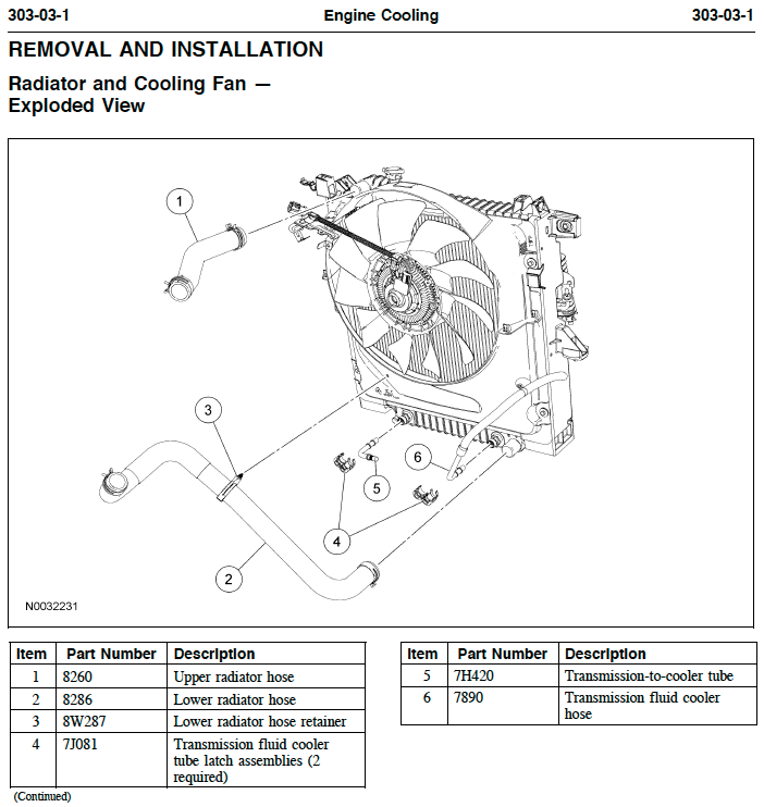

Having difficulty getting my radiator out for replacement. The single bracket holding both rad and a/c rad appears to be blocking the rad from lifting up. Is it possible to get cooling rad out of that bracket without evac a/c and removing all lines to a/c rad? Can't seem to get the clearance to remove cooling rad up out of the bracket that holds both.
2007 radiator removal
Thank you for the instructions. I don't have a "307-569" tool for removing the trans cooler lines. A reasonable substitue? Available after market?
