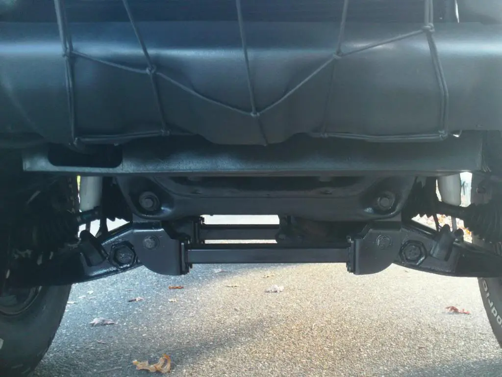

you will need the front knuckles
(as far as I know, these are always in stock...on the shelf)
you will need ALL the front diff. bracketry....and crossmember brackets.
and torsion bar brackets.

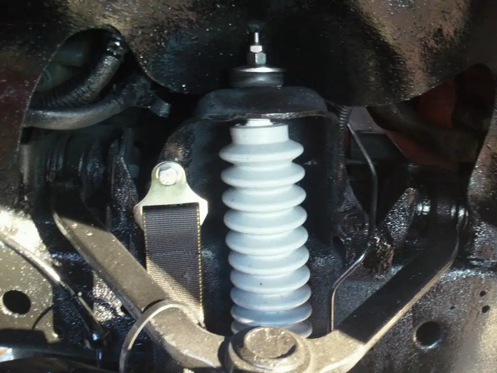

I also got the shocks that come with the kit. they worked perfectly.
length wise (these too are in stock, on the shelf) no boots though.

also comes with limiting straps for the front.
added a couple pics of the SOA for you also.

basically get both front boxes....
(they might have the swaybar brackets now
and it ships right away, you need to ask)

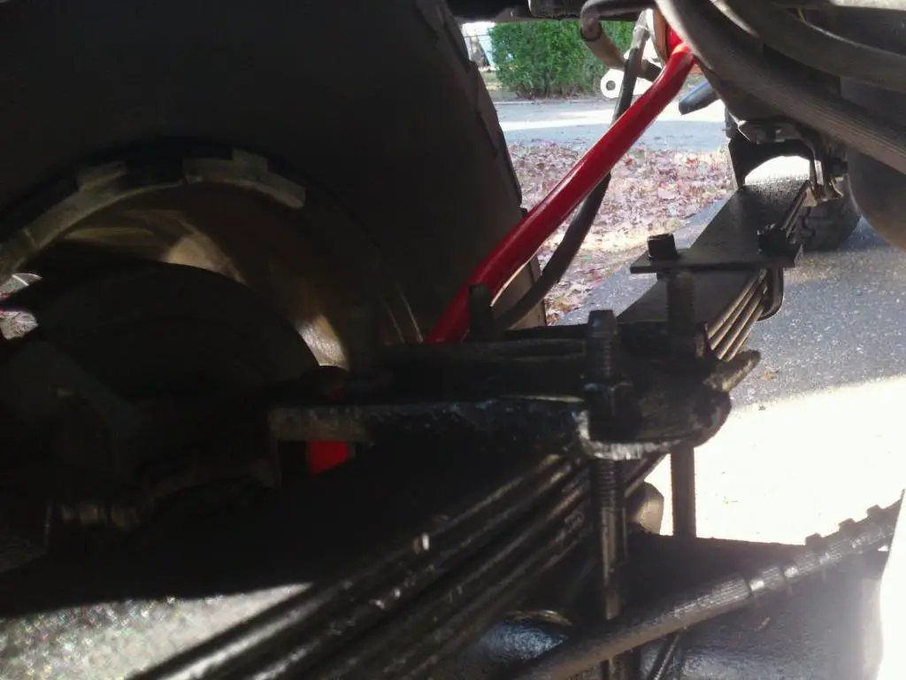

the rear, you will a need a set of perches, I got a set that didn't sit really
high. then grinded them down more to damn near flush, to avoid being
too high in the rear.
you will need to relocate your shocks, I ran mine on the upper sway bar hole.
until I decided what to do. I just cut them off the spring plate and welded
them to the sway bar bracket (on a slight angle).
if you plan to still use your rear sway bar, you will need to do something else.
and you will need some custom made links (longer).
I have the V8 so I had to make my track bars alittle longer (2in).
after the SOA they were too short. they are the red bars in the rear pics
(painted them red) brake line bracket, I just simply bent it down 90degrees.
straight down, to give me slack there, worked well and left it like that.
:salute:

I cut my trac bar, basically in half. found an old style lug wrench, (the same exact
diameter) and cut off what I needed. I then put everything in the vise and welded
the **** out of it. at first I didn't think it would be strong enough, but then I saw
there is not a lot of pressure or load on these bars, and it worked fine.
grinded everything smooth and painted. perfect.
they are only there to help with axle wrap, and axle twist.
you need to relocate the rear shocks because your putting the spring plate
on top of the spring pack now, instead on at the bottom, the shocks will be
WAYYYY too long...like I said, a lot of guys use the top hole on the sway bar
bracket, hell....or even the bottom hole, but the angle was too far off for my
liking.....so I simply cut off the shock mount from the plate, and welded it to
the sway bar bracket on the angle I wanted...(see the pics)..

BTW I got a warrior perches from summit....the 3 in. then grinded them down
to 3.25in to get them flush with the axle, which turned out to be a good idea.
as I was still way too high in the back by almost 3ins, but I took my warrior
shackles off and put back on OEM, and it sits just right for me..1.25..1.5in higher
in the rear....perfect haha

What did you use to convert your rear swaybar bracket into a lower shock mount?
I cut the old ones off the spring plate...
then just welded them onto the old sway bar bracket.
but on an angle.
you can see everything in the pic
