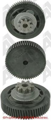

1. My rear windows, the easiest way I can think to say it is that they roll down TOO fast. When theyre going down, its like the motor goes faster than the window, because the windows "bounce" on the way down. If I put a little pressure on them, then they go down just fine. Both rear windows do it, only going down, not up.

1. I believe the power window motor gear has a rubber damper to take up the slack as the window moves up or down...I bet the damper is worn out or cracked up and fell out of the gear...Does the window motor start to move a sec or 2 before the window starts to move up as well?

1: Ill have to check them when I go home, are they something I could pick up at AutoZone?

1. I don't know if AZ carries the gear set; I do know that Rockauto does for about $13 each...There is a picture below...You can see the round rubber "pucks" between the large driven gear and smaller drive gear and hub...
