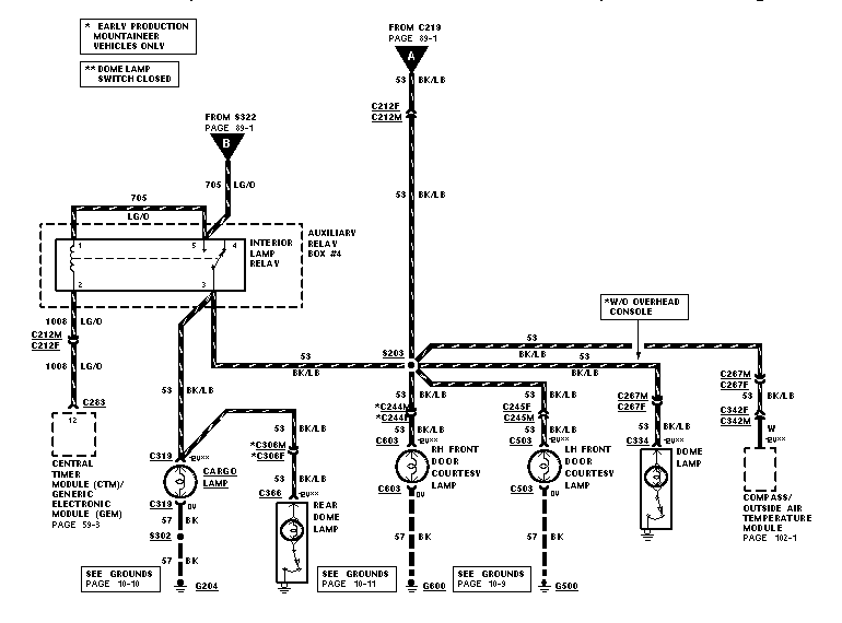

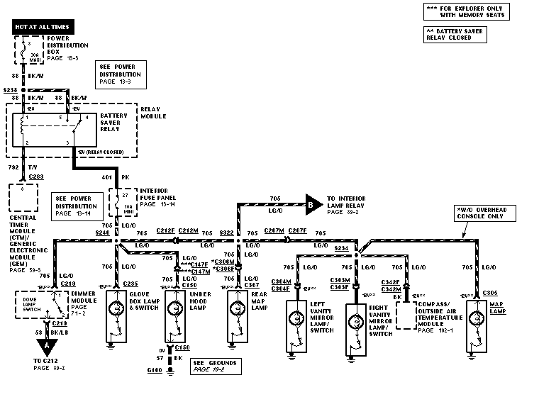

Any idea where i can find the courtesy light circuit on my 97?
What exactly are you looking for? A diagram?
A diagram works if you have it........if not the location works
Let me know if this has what you need. If not, tell me what you want to find and I can get it.
This should do it.....I'm wanting to rig some lights under my X to work with the enterior courtesy lights.
