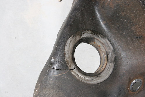

Was diagnosing a bad starter tonight and I found my mystery clunk when going over bumps. Looks like I don't have long before the radius arm goes all the way through the cross member.
How hard is the cross member to replace? Can I do it with just a jack, jack stands and a impact gun? Or does it need to go up on a rack? Can I even find this part?
It looks like your rivets were already replaced with bolts. If they were all changed, then its not that bad.

Just be careful and do one bracket at a time as those brackes are the only thing keeping the front end from rotating on the axle pivots.

Good news for you. Ford sells the mount (cross member) you need for $101. That is what they told me, You drill out the old rivets and bolt the new one in its place. Mine is not cracked but worn from the radius arm smacking it for so long. I just got my explorer less then a month ago.
I'm fixing mine this Thursday. Using an air powered chisel to knock the rivets out and bolting my new one in place. My explorer is a bottomless money pit. May be cheaper to torch it.

There are a bunch of threads on here about replacing the Radius Arm Bushings which is basically what you need to do. In your case you MUST you the pull bracket method since you are changing the brackets.
