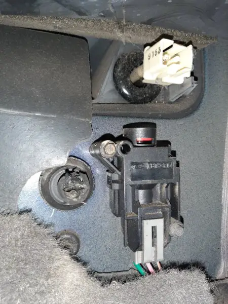

I have a 99 explorer 5.0, I started having battery issues and had to get a jump a few times. I replaced the battery started right up but after about 10 minutes it would shut off and just spin over and not fire while trying to crank the theft light flashes fast. After about I hour it will fire again but do same thing. Ok so I have a theft light code flash of 1-6. Now before the battery issues twice I had a beeping sound coming from dash area turned truck off and restarted sound went away. Upon searching I was thinking about replacing PATS modular and PCM and everything from a donor 99 explorer,well I was looking at PCM and when I pulled the plastic piece to look at it I noticed about 1000 ants in base of floor board by the panel. Also my shifter the little orange thing is no longer lining up with what gear while actually in park it shows it's in R. Any ideas of what the problem could be I'm out of work and have very little money and I need my truck to get a job.
