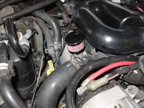

Do you have a picture that shows the setup you are running? Just interested to see what is involved. I think I will need to get a rubber grommit and the filter and then I should be good, not sure though haha. Any pictures you could offer would be great. Thanks
Here is a shot of the breather ....
What brand of breather is that? Did you need a grommit to put in with the breather?
Some "no name" brand that I picked up at Advanced Auto Parts. It has been replaced with a quality part ( EaAB ) from Amsoil ( http://www.amsoil.com/StoreFront/eaab.aspx ).
There is a grommet where the tube went into the valve cover; I reused that one.
Thanks so much for the help. Did the discount filter work alright for you? I will probably go the same route at first and then buy a quality one later on.
Having a bit of a problem with the breather. Bought a filter and it dosent fit. When I removed the hose from the stock location there is a post that is sticking up and the filter wont fit over it. Did you encounter the same problem?
Yes, I just got one that fit.
