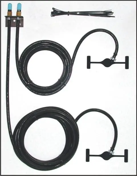

Hi Everyone! I spent a couple of hours today routing my front and rear Diff breather tube hoses up into the engine compartment! 1 Breather filter for the diffs, and 1 for the tranny and xfer case. I found the mod on this forum! Here's some pics:
After circling the engine compartment a few times trying to figure out where to mount the K&N filters I decided on this inspection plate.
Here's a shot of the piece of angle bracket I used.
I mounted the filters on the plate, then....
Hooked up the hoses that run to the T-connector down by the frame (also marked one of them with tape to tell them apart!
A pic of the completed project! They sit snugly there and should work well as far as NOT getting submerged!!!!

The breather tube is for the differentials and transmission to let off heat when they get hot, say you leave the stock one which is like 2 inches long up front like it is, then you go and wheel like a bat out of hell and get everything good and hot, then it will act like a vacuum to suck in cool airl, unless it wants to really cool off like if you would say, go into cool water, then you have just replaced all diff fluid with muddy water, so there you have a shot diff, cool and cooked.
