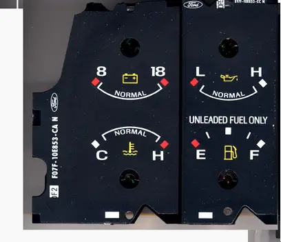

Okay, I think I have what some of you first generation guys have been looking for!

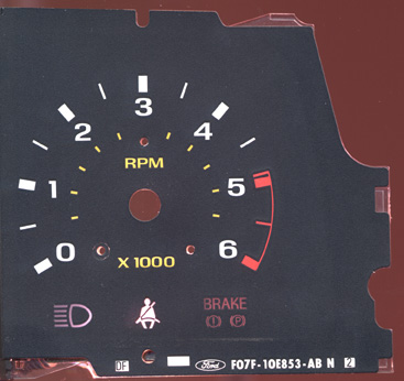

Here's the tach. It's a little offcolor but I had to do it to get the dummy lights to show.
  • tach/dummy.jpg
    tach/dummy.jpg

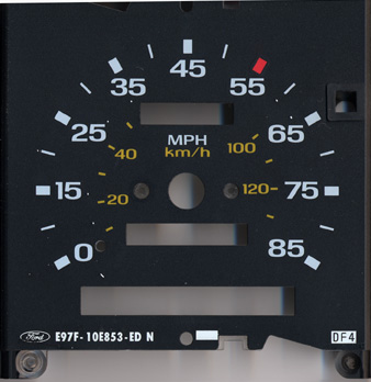

Speedo. Let's see your designs boys.
Yeah that's right, only three. And the high beam one is supposed to be blue but I had to light it from behind when scanning and that changed the color. The other two are red.
Thanks Zensius. Are these actual size?
