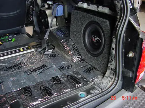

I also throw stuff into the cargo space. My set up is quite simple: 1 rockford fosgate 10" in a bandpass enclosure which sounds tiiiighht!!! Louder than many of my buddies with 2 tens in an enclosed box (of course they keep there subs in the trunk while we have a totally open area).
Anyways, the set up is relatively small and if i need the extra cargo room i just disconnect the 2 wires and remove the box. But as of yet I havent had the need to do that.
Also the cargo cover thingy covers the sub box perfectly
I dont know what your needs are but this setup is adequate for my simple taste.

OK. I started work on the enclosure. (I will post the pictures as soon as I can change my DNS entry now that @home screwed me up). Here is what I have decided to do...(explained the best I can)
I raised the floor a total of 6.5 inches. With 3/4 in boards that gives me 5 inches inside the "new" floor. At the front I am going to angle it up at 45 degrees so my speakers are pointing up and back. To fit the face of a 10" sub it will come up to the top of the trim just before the glass on the sides. Because of this I am getting all the airspace I need and want above the raised floor. You may ask why I still choose to raise the floor?... Well it is simple, with a raised floor I can hide my amps under the enclosure along with the pc I am mounting in my x (see: Dead Link Removed). Then I have the back half for storage, jack, tow rope... that sort of stuff, with a hinged lid. Will keep you all informed of the project as it goes along.
