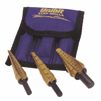

Here's what you do,
drill a 1/8" hole and get a step drill bit.. you can buy them in sets of 3-4 for $50 or get one for about $12-$15 depending on size that fit a 3/8" drill. the other's I've used go up to 3" -4 " but you have to use a 1/2" hammer drill.. and there more expensive like $25 - $50 apiece... but they make nice clean holes...
you can get them at sears and other hardware stores.. for the bigger ones you may have to find a MAC or snapon dealer...
here's a pic of a set that goes up to 3/4"...
