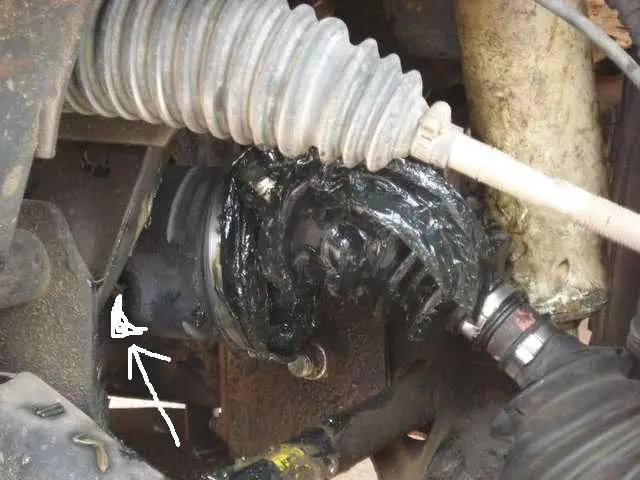

doing the PS side CV shaft on a 1996 EX... used the write up here and got 90% of the way , everything is removed or loose but the shaft is still in there. The write up says it should "POP" out but mine is in there pretty good.. The hub side came out no problem , but the engine side is stiff. am I missing something, are there screws to remove behind the rubber to get the shaft out ? I'm in pieces so any help on what to do is appreciated, I just don't want to kills the shaft as it has to go in my 2000.
See if this helps-
LOL OK ,, the arrow sure helps.. I'm going to hit it now...
you were right.. popped right out of the socket... getting the shaft out took some science..
