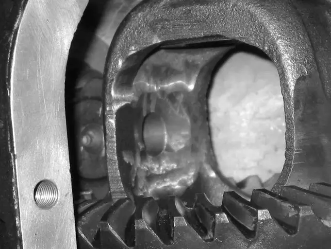

Is this the spot you are talking about?
attachment.php
Using a die-grinder should take care of any 'clearence' issues.
