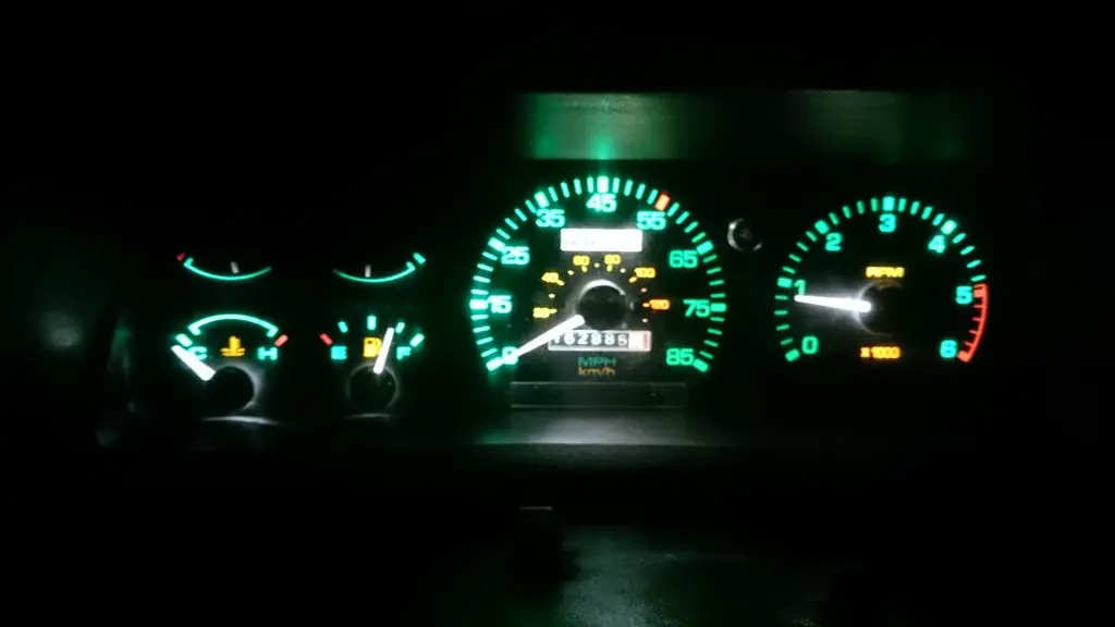

Both 94s I have use 194 bulbs. There are 5 bulbs for just the back lighting, but quite a few more for things like abs,check engine, parking brake etc. I just did the 5 backlash bulbs with white LED and they are very bright. I have to turn the brightness down at night. Whatever color you choose is what the dial arms will be. I wouldn't get red or green, but orange, yellow, blue, and white should work well.

Sorry, I almost forgot about this. It turns out its not the easiest thing to take a picture of. You get an idea of the colors with white LED bulbs at least. The green/red/orange looks the same as stock but the big change is the gauge arms and odometer/trip, and both are extremely bright white.
I was noticing my gauge cluster tonight, the needles are orange but they are just clear plastic like you said. I've got some white LED's ordered, very curious to see how it ends up. Thanks for the update picture.

Here's a picture of mine, pretty much identical results to 2stroke. It was a pain to get everything apart, especially the speedo cable but in the end, it's well worth it.
