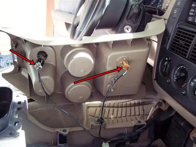

I believe the fuse #24 in the fuse panel under the dash is for the cigarette lighter if you have the smoker's package. The arrow on the right points to the connector for the cigarette lighter. It is snapped in place without the smoker's package as shown:
Hope this helps out. :thumbsup:

I also picked up a 2002 Explorer, Eddie Bauer edition. Cigarette lighter in front was dead, the one in back for passengers works fine. BUT (lol):
In the picture, the orange connector to the right is ALOT shorter, and not connected to anything (where it goes into the console in the picture there's a removable plastic cap). But it's so short, it wouldn't reach it anyway. This connection is always live, I checked. The one I need to replace is the one behind it, the black and grey one. Trouble is, it's dead. I checked the appropriate fuses (24), it's fine, but haven't checked the Power Point fuses yet. Some things I don't understand, Is, theoretically, I have 3 power points. The orange one, the black/grey one, and the one in the back for passengers. I assumed, falsely, that one was for the 2 in the front, and the other for the one in the back for the passengers, but since I get power from the orange, and not from the black/grey, and also from the back passenger one, that isn't true.
I'm replacing the cigarette lighter that is at the black/grey connection, as the previous owner filled it with Coke or something.. lol, but can't get power to it. I DO get power to the orange one, but again, it is always on, even with the battery out. Any tips on what to check for (will check the power point fuses, but since back and orange work, and black/grey don't, I don't think that's it), would be appreciated.
