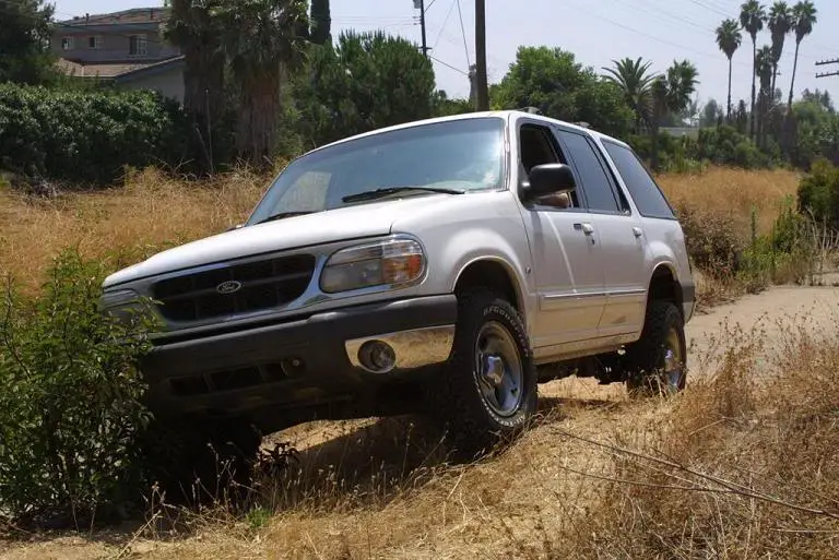

I have a 99 exploder and it has been the strongest truck I have ever driven. It has taken everything I have thrown at it, and kept moving. A few buddy's and I are going out to the Azusa canyon OHV area this weekend. My explorer is completly stock and Im worried about the creek crossings. I waded through one last week and its atleast two feet deep. Will this pose a problem for my truck? The depth doesnt worry me all to much, its whats laying in wait on the river bottom. I have 30 inch tires, while every one else has atleast 33's and 37's. Bottom line is, Should pass on this creek? Has anyone else done anything this deep in a stocky?
Jake
Not a great picture, but thats my truck.
fixed :D
