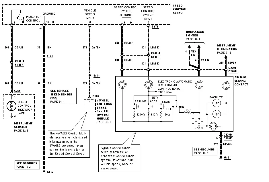

This might help. Doesn't have pin numbers on it but it looks to me like the switch itself only has 3 wires on it. Could you post some pictures?

Oh and the picture you posted is like greek to me, I don't understand those things at all.
I just found one in my son's collection and it looks just the way your photo shows. 1 pin an empty pin then 5 more pins. So it looks like yours should be ok.:thumbsup: I've never replaced one but he has done several. Hope this helps.:salute:
