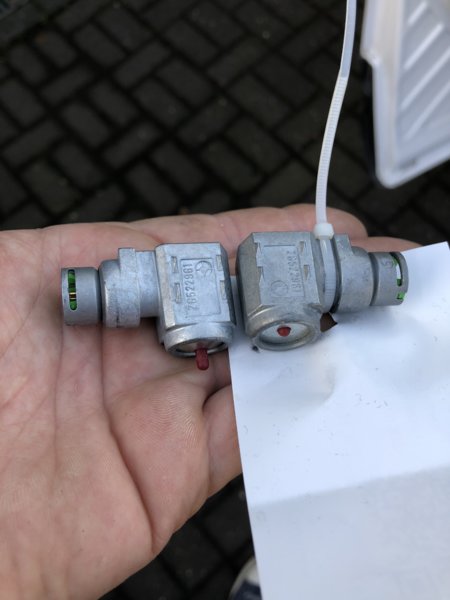

I checked at my car. The red pin popped out. I will order the part and exchange it. Hopefully it is enough to unscrew the 4 bolts and drop down the steering column to remove the sensor.

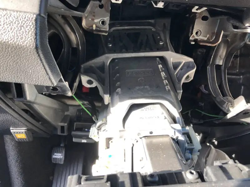

If the red pin has popped out then the column has shifted forward 1/8 of an inch. Doesn't sound like much but enough to not fit the new sensor it's easy easy to fix this . Order new sensor. Take the plate off the top that holds it in it has 4 t25 torx I believe they hold it down the spot you will see that hits the new sensor . Very center just Dremel it a bit (1/8" ) so it fits snug over the new sensor .plug it in and you're good to go. And yes u can just drop the column down and reach it all without removing it from the car. And yes the air bag light will come on without that resistor bc it sees a break in the signal when it does the check.it is fine to leave the resisor in place until you receive the new sensor

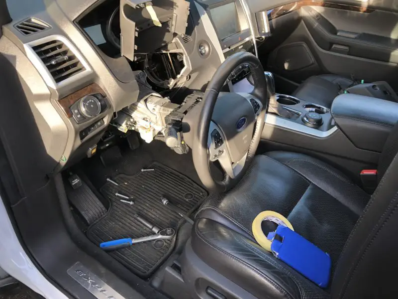

Just to update everyone. I exchanged the Collapsable Steering Column Sensor. It’s an easy task, if the sensor is popped out without any damage/movement to the steering column.
Just remove the covers under the steering column and all the covers you would remove to access the fuse box.
Afterwards the 4 M8 Bolds of the steering column are accessible.
You are now able to lower the column and have access to the cover of the sensor, hold by 4 25 Torx bolds.

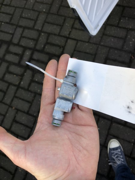

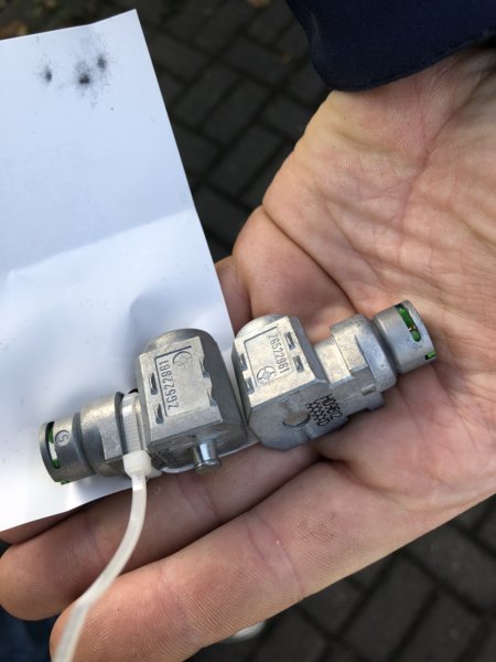

For me it worked quite well. The sensor is disassembled from a Russian Ford Fusion (not the US Fusion, I mean the European Fusion which is a small car based on the Ford Fiesta. Ford Fusion (Europa) – Wikipedia )
The Number on both Crash Sensors is ZG522961
