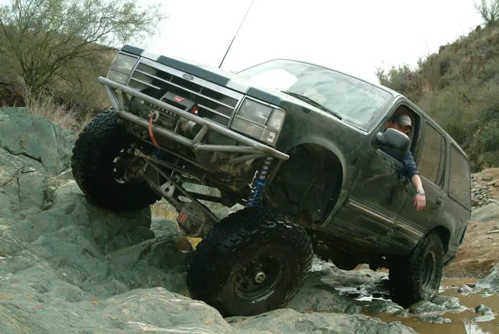

It doesn't really talk about it in the article, but I like the 3-link suspension that it has. The coil-overs come in a variety of spring rates, so I would imagine that I can get the right rate for the weight of the Explorer, but what about that suspension. I want to do this, so I'm starting my research. I have read through a lot of the SAS threads on this website, but I want to know what it would take to put together a suspension, just like that one.
To those who have gone through this or that do this for a living, what parts do I need and what steps should I take? Also, does this type of setup usually handle well on the roads, or will this make it a trailer queen?
To this date, I think there are three 3-linked Explorers: Rick's, Michael's, and mine -- all of us have SAS threads on here somewhere so I guess thats the first start.
here's a pic of Michael's on its first true run :D
But that is indeed a great price for a set of coil-overs. Great find Dignan
