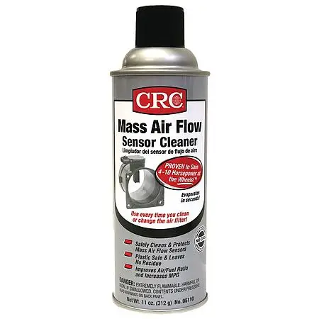

Get a can of this, thoroughly spray that IAC Valve, and allow it to dry before putting it back on. May require a few cleanings. Also, clean the Mass Air Flow sensor right after the filter in the air intake.
MAF Sensor Cleaner
I thought you had to use throttle body intake cleaner on the iac valve? Not sure what the difference is but while you are messing with that area i cleaned my throttle body with the intake cleaner cuz the gas pedal was sticky but I was surprised how dirty it was
MAF sensor cleaner is similar to electrical contact cleaner and is ineffective at cleaning carbon and varnish deposits.
IAC valve cleaning is easier using throttle body or carburetor cleaner with a small stiff bristled brush. Soak, then scrub.

brake/parts or carb cleaner works fine for the IAC valve (and it's cheaper) but use only MAF cleaner on the MAF sensor.
