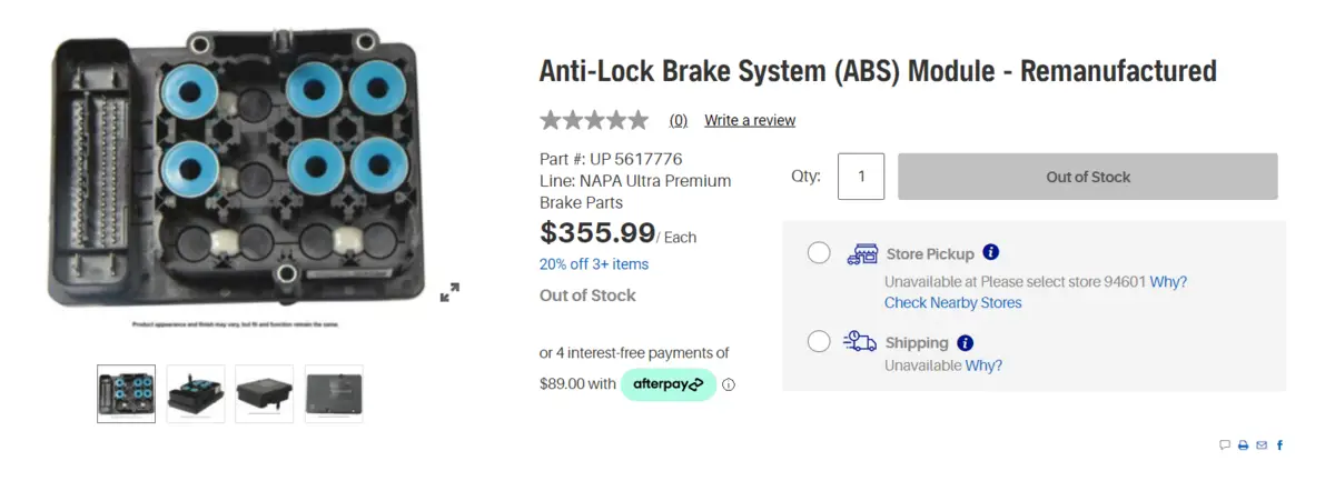

Finally, I took it into my mechanic. They said I needed a new, rear-right ABS sensor for the braking problem, and a new throttle body for the limp mode problem. I had them put in a new ABS sensor and I replaced the throttle body myself ( it definitely needed it). NO MORE FAILSAFE MODE! However, the ABS light came back on and the brakes kept seizing as I tried driving off. I took it back in to the mechanic and after a few days they determined that the ABS Module (NAPA part #: UP5617776) was bad and needed to be replaced. Problem is, that it is discontinued and not available ANYWHERE, except maybe eBay.

Do you know if the part you need is the ABS hydraulic valve module (the metal part where the hard brake lines connect), or the ABS control module (the plastic part with the brains)? The listing you posted at NAPA isn't clear on this, possibly because it's out of stock.

Sorry, I forgot to mention that. I've got a 2005 4.0L 4WD XLT with traction control.
The part my mechanic said I needed was this one
Thanks for the clarification.
RockAuto lists that Cardone does a return and rebuild service for the ABS control module you need. The service goes about $250 +ship. Cardone is not my first choice for auto parts but you may have limited options. I don't know how long the service takes.
This is another site that advertises return and rebuild in 3-5 days,
UpFix Ford ABS Module Repair
If you are thinking about giving one of these a try, contact the site and make sure they can do the repair on your year, make, and model. Looking for a few reviews wouldn't hurt either.
The Ford part number for your control module is 4L2Z2B373CB. A search on that part number doesn't reveal anywhere that says they have them.
