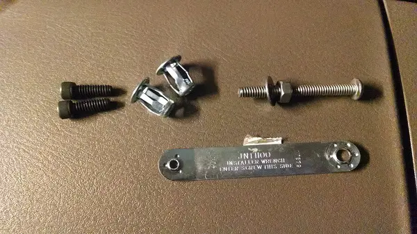

First thing to do was to gather the tools, parts, etc. I used 1/4"-20 Allen head bolts to secure my handle. I found the jack nuts at my local True-Value hardware store.
The long screw, nut, washer, and flat steel tool will be needed to install the jack nuts. I would recommend getting a couple extra jack nuts just in case you over-tighten or strip out the threads. http://www.thread-rite.com/pop_nuts/jack_nut_installation.htm Also, you will need basic hand tools, an electric drill with a Uni-bit (AKA step drill), a Dremel or equivalent rotary tool(preferred, but I suppose you could use hand files).

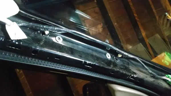

Next was to remove the driver's A-pillar trim piece and locate the two existing square holes where the handle will bolt to. At this time, pop out the wire clips and disconnect the green connector(visible @ extreme right of the next pic) to get this wire out of your way. Using my Uni-bit, I VERY slightly rounded out the holes so that the jack-nuts would fit.
the jack nuts installed...

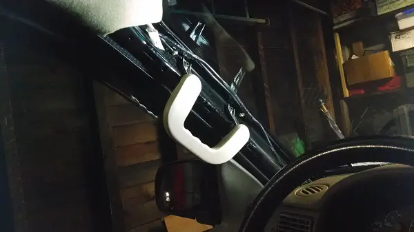

Once I had successfully installed the jack nuts (it is a PITA due to the proximity of the windshield) I test fit the handle.

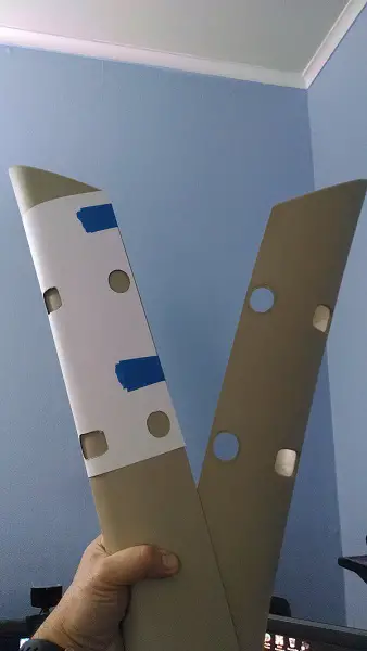

Now onto making holes for bolt access and the handle mounting arms. Using the passenger's side trim piece I got from Ebay, I made a template with some card stock paper.
Transferring the template to my driver's side trim piece, I first used my Uni-bit again to remove the lion's share of material and then finished up with my Dremel.
Use caution when test fitting everything as I managed to snap off one of the metal clip retainers on the driver's side trim piece. After a few test fits I was pleased with the final product. The handle has a slight angle to it since it was meant for the passenger side, but I can't tell unless looking closely.

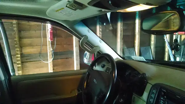

So the mounting holes were already there then?

Yes, there are two square holes already punched from the factory.
Makes sense. These bodies are produced for right hand / left hand drive I believe.

Hey, what's the tool do? Can I get by without it?
Sorry for not replying promptly. I couldn't get the jack nuts to tighten correctly without the installation tool. I'm sure something could be fabricated at home but for the couple bucks it cost to get the tool I figured it was worth it.
As it wasn't available in town, I modified a Simpson tie for the purpose. Having removed my running boards, I use this mod all the time.
