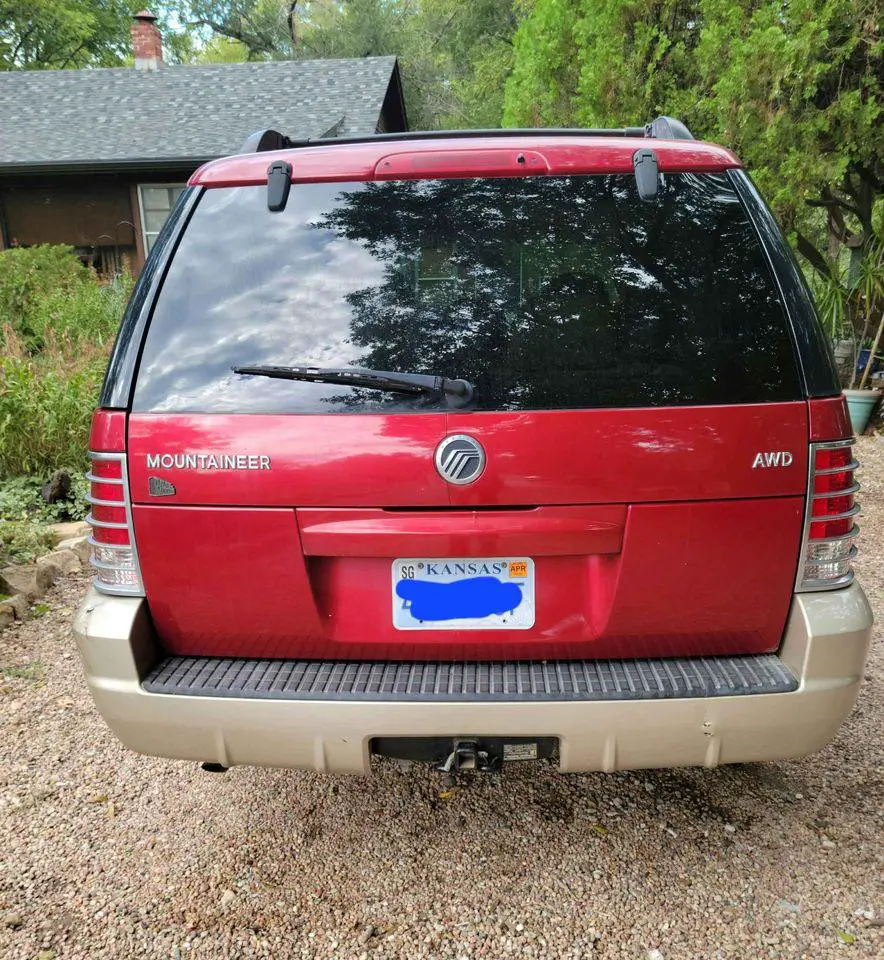

The vehicle says it is awd. What is your rationale for stating that it is not AWD (as much as I wish you were right)?
https://imgdump5.novarata.net/mj8cs0.jpg
I had thought that the Mountaineer only came with AWD if it was the 4.6L V8 but looking around, I saw a pic with the same "AWD" liftgate emblem and listed as a 4.0L, and a V8 that had the emblem as "AWD V8", so IDK.
