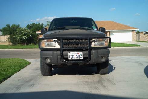

Mine wraps under the whole peice on my 99 which is probably bigger, so I think you are allright. Here are the pics.
I know its not exactly what you wanted, but I hope it helps.
-----Nate
Matt,
Sorry I don't have a Manik guard so things are probably different. My guard slips right through the air dam area...no cutting needed. I did have to drill holes in the frame to mount the beast though. Drilling really was not all that hard, but of course, there are permanent holes in the frame.
I just thought I'd give you an idea how mine went on.
Ken

Am I correct to assume that this does not techically attach directly to frame, there are brackets to the frame, then the gaurd to the brackets?
Yes, when I get my car back tomorrow I can give you measurements. I know I wouldnt trust it with a winch or a tow rope at all as is, but they do protect your car if the situation arises......
That last picture is where the bracket attaches to the frame. That drops down about I would say 2-3 inches mabey more where the brushguard bolts up with 3 bolts.
