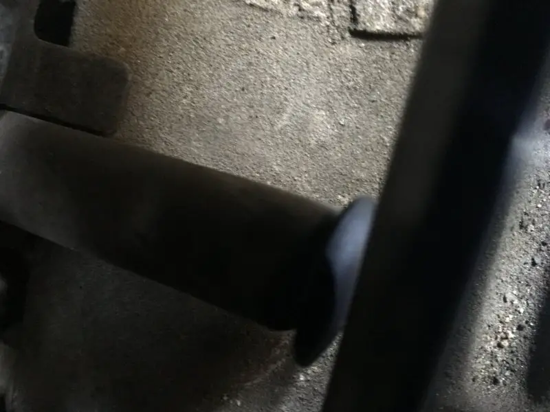

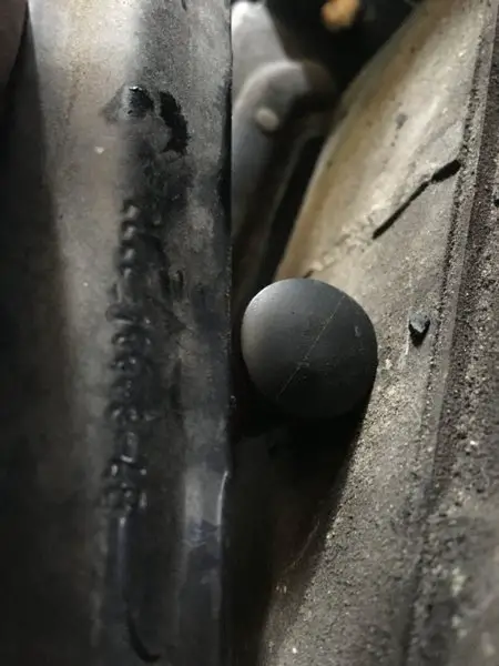

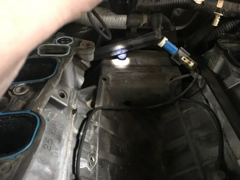

Hi, I removed the intake manifold and I found a hose back by the firewall that is capped off with what looks like one of those plastic push retainers that usually hold plastic/rubber panels and stuff. Does anybody know what it is? If its supposed to be capped off? Thanks
05 explorer eddie v8 4.6
That is in the same location as my transmission vent tube. It should not be plugged, but usually they have a clip and the hose turns back towards itself. Where does it end up plugging into?
