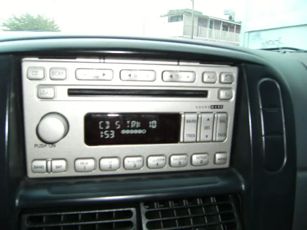

This is the one I got @ ebay for US$100:
It plays MP3s, has also aux in and SAT (haven't gotten the modules for these 2 options) It has manuf date of 40/'06 so it's either for an '06 or an '07 not sure
^^^that's the 04-06 navigator radio, not the 06+ radio
It says it works right? so what if it wasn't offered hehe I don't that will matter :P it didn't matter to me when I put the above one (which btw said it came off of an explorer, and the harness I got was for a ford explorer, also at the jy they had one exactly like mine on an explorer)
