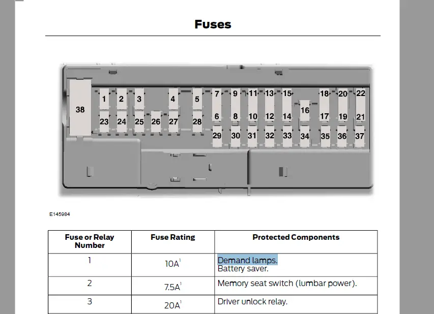

Any idea what fuse controls interior lamps? I am not seeing it on the PDF owners guide for explorer 2018MY. I only see DEMAND LAMPS/BATTERY SAVER on interior fuse 1.
There doesn't seem to be a fuse for it anymore. I checked as well and should have noted that in my post. The fuse for the "Courtesy" lamps seems to have disappeared along with some others with the 2016 Explorer 'refresh'.

I may have to drop the $140 for a 2018MY DVD. Or just $20 for the wiring manual.

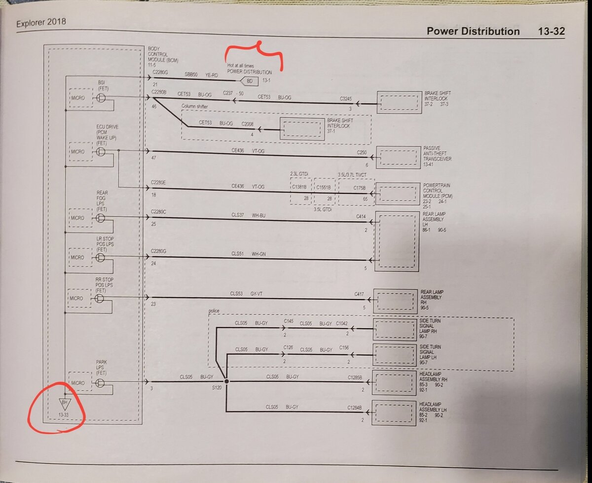

I am waiting for my sister to let me know if the changes made by enabling silent mode 5 do as she likes, the wiring diagram arrived.
Since she doesn't want wires cut, I looked to see what fuse ran this circuit. I didn't realize the below systems on the same fuse.
- brake shift interlock
- pats
- pcm
- rear lights
- Police turns
- head lamps
- front right fog
-Police right side turn
- right hand mirror
- third row seat
-multi contour seat
- glove box light
-2nd row seat
- vanity mirror
