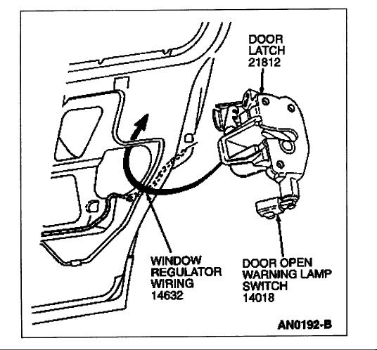

The sensors in the doors are an easy fix...
although it is like a $15.00 part that the dealer will charge you almost $250.00 to replace.. because of all the labor to tear the door apart..
My brother in law had replaced 2 of them for me at his school a few months ago,and it was about $15.00 for each switch..
he told me a buddy he works with at his school had that problem and didn;t want to wait and had the dealer replace the switch and that is the amount that they charged him $250.00 which is a little bit crazy if you ask my....
Removal
1 Remove the front door trim panel and watershield from front door.
2 Remove the power door lock actuator from the bell crank.
3 Disconnect front door latch actuating rod from lock cylinder.
4 Remove the rivet from the front door latch remote control and link and
power actuator bell crank.
5 Remove the front door latch remote control and link from the front door.
6 Disconnect front door latch control cylinder rod from front door latch.
7 Remove front door latch from front door.
Installation
Follow removal procedure in reverse order.
Tighten front door latch retaining screws to 21-29 Nm (15-22 lb-ft) .
